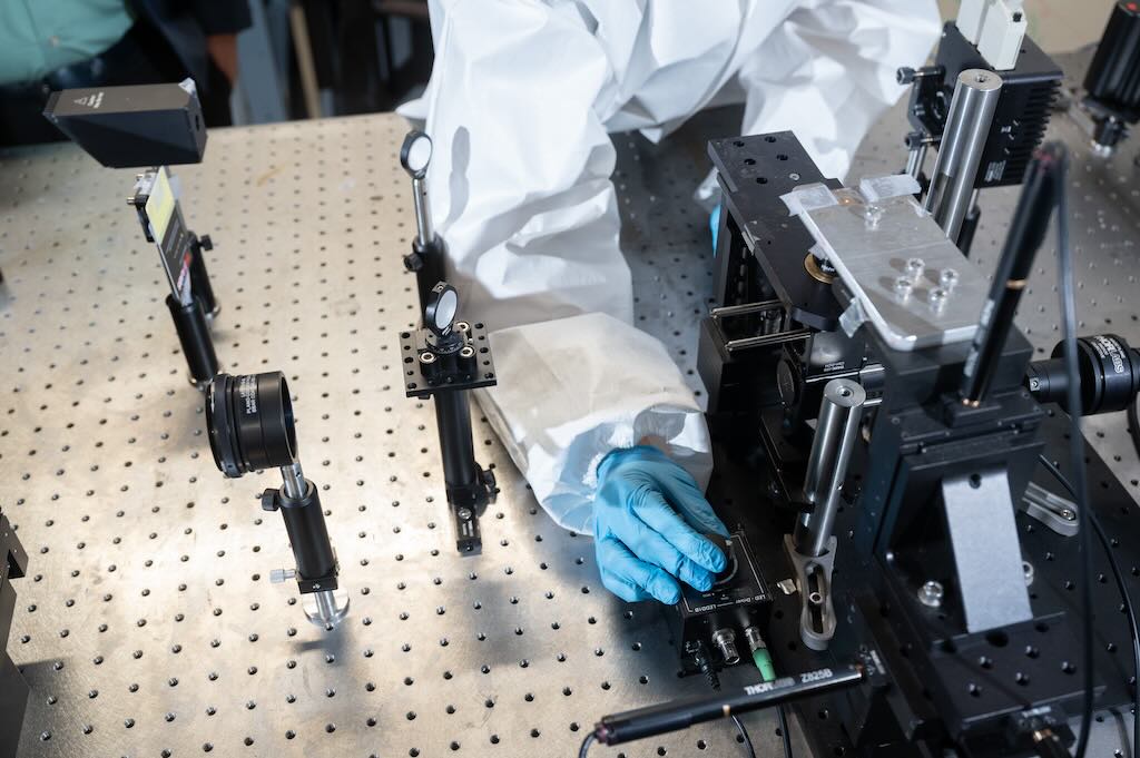

Georgia Tech researchers work in their lab.
Georgia Tech researchers work in their lab. Courtesy: Georgia Institute of Technology
