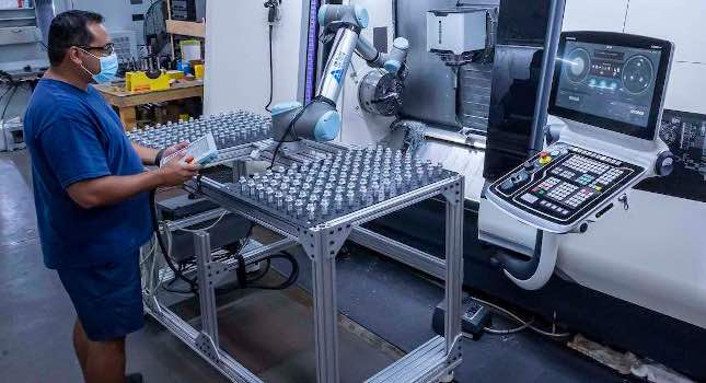

In the Lone Star State, it’s collaborative robots vs. COVID, as Universal Robots comes to the aid of a small machine shop. All Axis Machining, a metal fabricator in Dallas, Texas, already had a small team of collaborative robots on the shop floor performing an array of tasks, including machine tending, sanding, deburring, and wire EDM. Automating with collaborative robots a couple of years ago increased their spindle run time from 8 to 20 hours a day.
“Now we have just a few people in the shop, and the cobots’ better productivity results in lower operating costs and more manufacturing hours available,” said All Axis owner and CEO Gary Kuzmin. “It’s the best thing I ever did.”
In the midst of the pandemic, All Axis added two more UR collaborative robots to keep their tools at maximum capacity and help socially distance the shop’s manual labor. They also added a weekend shift to disperse staff density. They now have eight collaborative robots running 24/7 across three shifts. The third shift is completely lights-out.
“Cobots allow us to keep employees socially distanced in a way they feel comfortable,” Kuzmin said. “We now have more robots working and minimal crew taking care of non-robot actions. This shift in operations was all driven by COVID and with the help of the cobots, it’s working out very well for us.”
