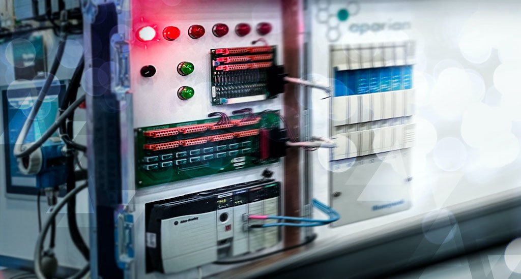

Intelligent design can deliver the right alarms to the right operator at the right time, with appropriate importance, context and guidance to correct or quickly mitigate the situation. These indicators show an alarm state at a 2021 Automation Fair display in the Maverick Technologies booth. Courtesy: Maverick Technologies, a Rockwell Automation Company
