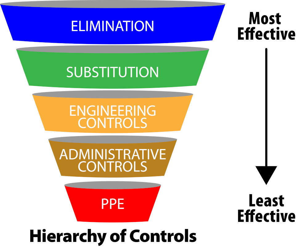

A traditional approach for personnel executing safe design is to consider several layers in a hierarchy of controls to provide a complete safety solution (Figure 1).
Figure 1: A hierarchy of controls approach to safe design prompts the consideration of the most effective methods first. Courtesy: AutomationDirect

The term “hierarchy of controls” does not refer to real-time controls, but instead defines what steps users should take to control and limit the hazards presented by any equipment or installation. There are often many potential steps which can be applied, in conjunction with each other to some extent. There are five layers involved in this process.
1. Elimination of the hazard to reduce risk
The best and most effective risk mitigation step is elimination, which means removing or deleting the potential hazard. Unfortunately, this is not a viable option most of the time because most machines and processes cannot be designed in a way to remove all possible hazards. However, designers should always consider elimination as an option.
For instance, a machine may have an easily opened inspection hatch, exposing users to potentially hazardous access. The hatch could be replaced by non-movable sheet metal, but that would be a problem for maintenance teams. Perhaps installing an interlocking safety switch and making the hatch openable only with tools is a better approach.
2. Substitution of the hazard to decrease risk
Even if a hazard can’t be eliminated, it may be possible to perform a substitution, replacing the hazard with something less severe or requiring less frequent access. Sometimes this isn’t possible. For example, when it comes to equipment using chemicals, perhaps a safer chemical — from the standpoint of flammability or toxicity — could be available. Even if the safer chemical costs more, it would often be worth it to realize benefits, such as more efficient work practices and fewer potential incidents.

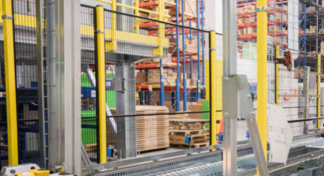

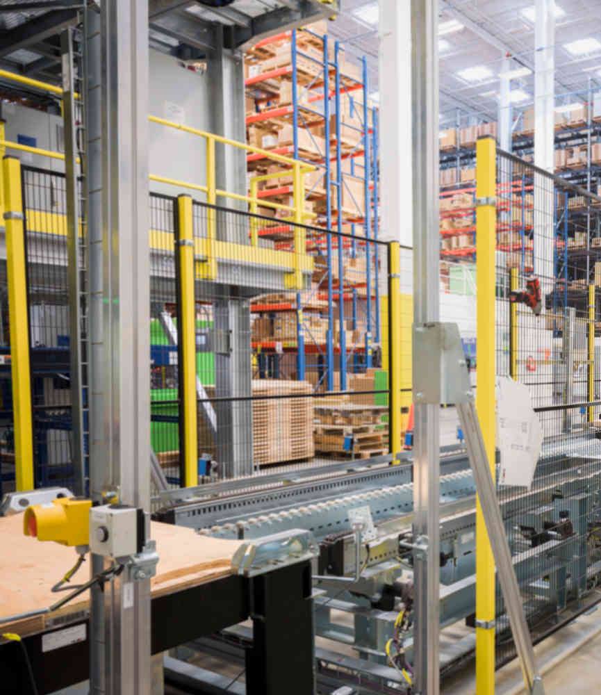

Figure 2: This warehousing installation shows physical fencing to guard users from the moving equipment, and an e-stop button (lower left) so users can rapidly force all equipment to a safe state. Courtesy: AutomationDirect

  • Physical: Adding gates, guards, walls, cages, and bollards are a simple yet important way to safeguard users (Figure 2).
  • Sensors: Many types of sensors can detect dangerous conditions or that may be triggered by users to indicate and mitigate a hazard. These include emergency stop (e-stop) buttons, e-stop pullcords, light curtains, limit switches, and others. Any one of multiple sensors wired or programmed in series may be used to initiate an e-stop (Figure 3).
  • Interlocks: Some safety sensors are interlocking, which means they can be locked closed to prevent users from opening the associated equipment unless it is safe to do so.
  • Removing energy: Sensors and interlocks can be wired via safety relays or safety controllers, to disconnect energy to motors, actuators, and any other devices which could otherwise harm users. Energy can take several forms: electrical mains power, electrical device power and most often missed is pneumatic energy and even hydraulic energy. Sensors may be wired to remove energy, or they may be designed as part of more capable hardwired relay or digital safety controller circuits. Safety controllers are advanced digital devices,  are very configurable via software and can communicate with higher-level systems.
  • Stop kinetic motion: Certain physical systems require additional attention to prevent motion even after energy is removed in the event of an e-stop. Pneumatic circuits may need a quick-dump valve to remove pressure from cylinders that might otherwise move. Equipment like vertical presses or shears may need mechanical stoppers to prevent movement due to gravity after an e-stop. Motor-driven mechanicals may call for brakes to stop rotational motion after an e-stop.

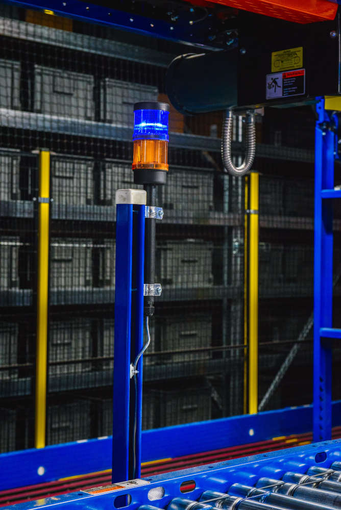

Figure 3: Although some other methods are preferable, there is still a need for administrative controls, like clear warning lights and labels. Courtesy: AutomationDirect

4. Administrative controls to lower risk
After the preceding steps have been incorporated, it is important to address the human element. This includes any design, engineering, maintenance, contractor, visitor or other personnel who will work with the equipment, or could potentially be in the area.
A training program is important for making users aware of safety concerns, work practices and proper procedures. Rigorous lockout/tagout (LOTO) procedures are essential for protecting workers who need direct access to equipment. In addition, clear warning labels, signage, and indicator lights provide an additional layer of protection.
