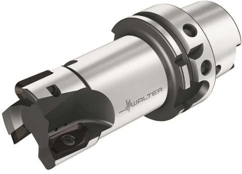

The M2131 Sky-tec ramping cutter allows shorter machining time due to its high metal removal rate and delivers long tool life.
The M2131 Sky-tec ramping cutter allows shorter machining time due to its high metal removal rate and delivers long tool life. It has high levels of process reliability to the machining of non-ferrous metals such as the aluminum wrought allows or aluminum lithium alloys often used in aircraft structural components. This 90° shoulder milling cutter with ramping capability has a maximum cutting depth of 0.59 in or 0.78 in (15 or 20 mm), a diameter range of 0.98 in-3.14 in (25-80 mm), and a high level of radial runout accuracy. The M2131, with integral cooling for MQL or emulsion, has a finely balanced basic body, with different interfaces such as HSK, ScrewFit, cylindrical shank or shell mill mount.
