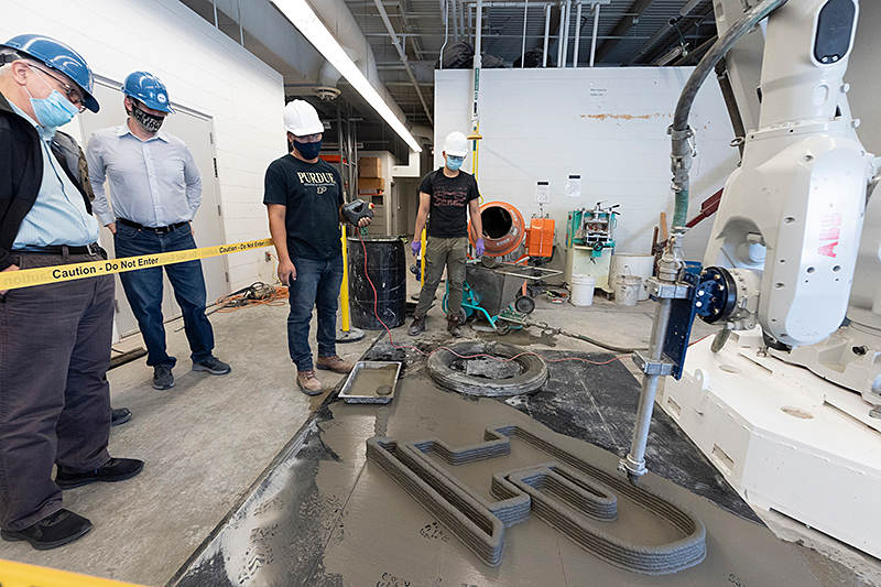

Purdue University Ph.D. student Fabian B. Rodriguez (second from right) explains the 3D printing process to faculty advisors Jan Olek (left) and Jeffrey P. Youngblood (second from left) in Purdue University’s Robert L. and Terry L. Bowen Laboratory. They are conducting research into RCAM Technologies' 3D-printed suction anchors to replace traditional anchors for offshore wind plants.
Purdue University Ph.D. student Fabian B. Rodriguez (second from right) explains the 3D printing process to faculty advisors Jan Olek (left) and Jeffrey P. Youngblood (second from left) in Purdue University’s Robert L. and Terry L. Bowen Laboratory. They are conducting research into RCAM Technologies’ 3D-printed suction anchors to replace traditional anchors for offshore wind plants. Courtesy: Vincent Walter, Purdue University

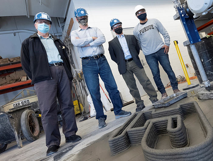

Purdue University engineers (from left) Jan Olek, Jeffrey P. Youngblood and Pablo Zavattieri conduct research with Ph.D. student Fabian B. Rodriguez (far right) on concrete 3D printing technology from RCAM Technologies.
Purdue University engineers (from left) Jan Olek, Jeffrey P. Youngblood and Pablo Zavattieri conduct research with Ph.D. student Fabian B. Rodriguez (far right) on concrete 3D printing technology from RCAM Technologies. Courtesy: Vincent Walter, Purdue University

Fabian Rodriguez, a graduate student in the Lyles School of Civil Engineering working on the project, said the research focuses on developing the 3D-printing process at larger scales.
“Being able to understand the behavior of cementitious materials in different 3D-printing systems allows us to have a clear idea of the physical characteristics and quality of the materials that we want to use for large-scale construction in marine environments,” Rodriguez said. “The current robotic system will allow us to produce larger elements on which we can evaluate properties such as their strength and durability.”
Olek said a challenging aspect of this application of 3D-printed concrete is that it will be exposed to a marine environment.
“That means exposure to elevated levels of chlorides that can chemically react with the hydrated cementitious matrix and potentially negatively impact the durability of the anchor,” Olek said. “We are looking into the microstructure of concrete created during the layer-by-layer deposition process. We want to know how it influences the permeability and rate of ingress of chlorides into the printed element and to assess impact on durability.”
Youngblood said, “3D printing can be overhyped, as in many instances it is a more expensive way to make something worse. 3D printing shines where labor costs are high and structures are unique and/or complex. Here, it has the chance to really make an impact, as construction is labor-intensive, and this particular design would be difficult with other manufacturing methods.”
