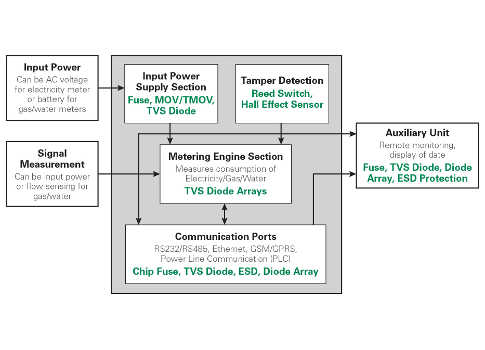

The following section investigates the specific protection requirements for each block of the smart meter solution shown in Figure 1.
Input power supply section: If it’s an electricity meter, then it is powered by input mains, which are highly prone to high energy transients arising from lightning or grid disturbances. Metal oxide varistors (MOVs) are used to protect against these transient surge events. To protect the wiring from fire hazards in case catastrophic damage in the power supply causes a short circuit, a fuse is also used at the power supply’s input front end.
Metering engine section: A microcontroller or digital signal processor is typically used for energy measurement and processing purposes. Although the power supply to this microcontroller is protected from transient surges, the analog signal-sensing pins of the microcontroller are still connected to the input supply for measurement of voltage and current. Although these signal pins normally have a high value of resistances and capacitors connected for filtering purposes, some fast-rising transients can pass these filter stages and reach the microcontroller, which is very sensitive to transients. To prevent damage to the microcontroller, very small transient-protection diodes are used on the signal pins to clamp any incoming transients to safe levels.
Communication ports: Depending upon the meter application, a number of communication ports might be used, including RS-232/RS-485/Ethernet/GSM-GPRS, power line communication (PLC) or optical ports. Because each of these port types has different operating speeds and specifications, they will need different protection schemes. (See sidebar for an example).
Tamper detection: Utility companies use smart meters to track usage so they can charge users for their consumption. However, this causes some users to try to tamper with the meter and manipulate the readings. As a result, these meters are typically designed with a host of tamper-detection techniques.
The simplest, most common tampering technique is to open the meter cover and damage it. By using a reed switch with a magnet or microswitch in the design, this sensor detects when the cover is opened and sends a trigger to the microcontroller. After recognizing the tamper attempt, the microcontroller notifies monitoring support staff at the utility company who, in turn, can impose a tampering penalty on the user.
Another method of meter tampering involves bringing a magnet close to the meter’s body, which can either cause the magnetic transformer to saturate or affect other components. When a Hall effect sensor is employed in the design, it detects the field of the magnet and gives a trigger to the microcontroller to record the tamper event and inform the utility company.
Another severe tampering technique involves causing an ESD discharge to the meter body using a spark plug or CRT-EHT generator. In this case, the meter enclosure is made using plastic to fully isolate the electronics circuit from the external world and minimize the impact of this ESD discharge. The microcontroller’s power supply and signal-sensing pins will have ESD protection diodes to protect the microcontroller from any ESD discharge that still gets coupled to it. With the first two tampering techniques, the microcontroller can send details on the tampering attempt to a control/monitoring station for assessing a penalty or just to protect the meter from getting damaged.
Auxiliary power supply section: Smart meters sometimes have an extension unit that goes into the user’s home while the main meter is installed at a centralized location in the building. For these applications, the home extension unit may have a Power over Ethernet (PoE) adapter. This communication cable requires additional protection because it can be susceptible to induced surges in the building.
