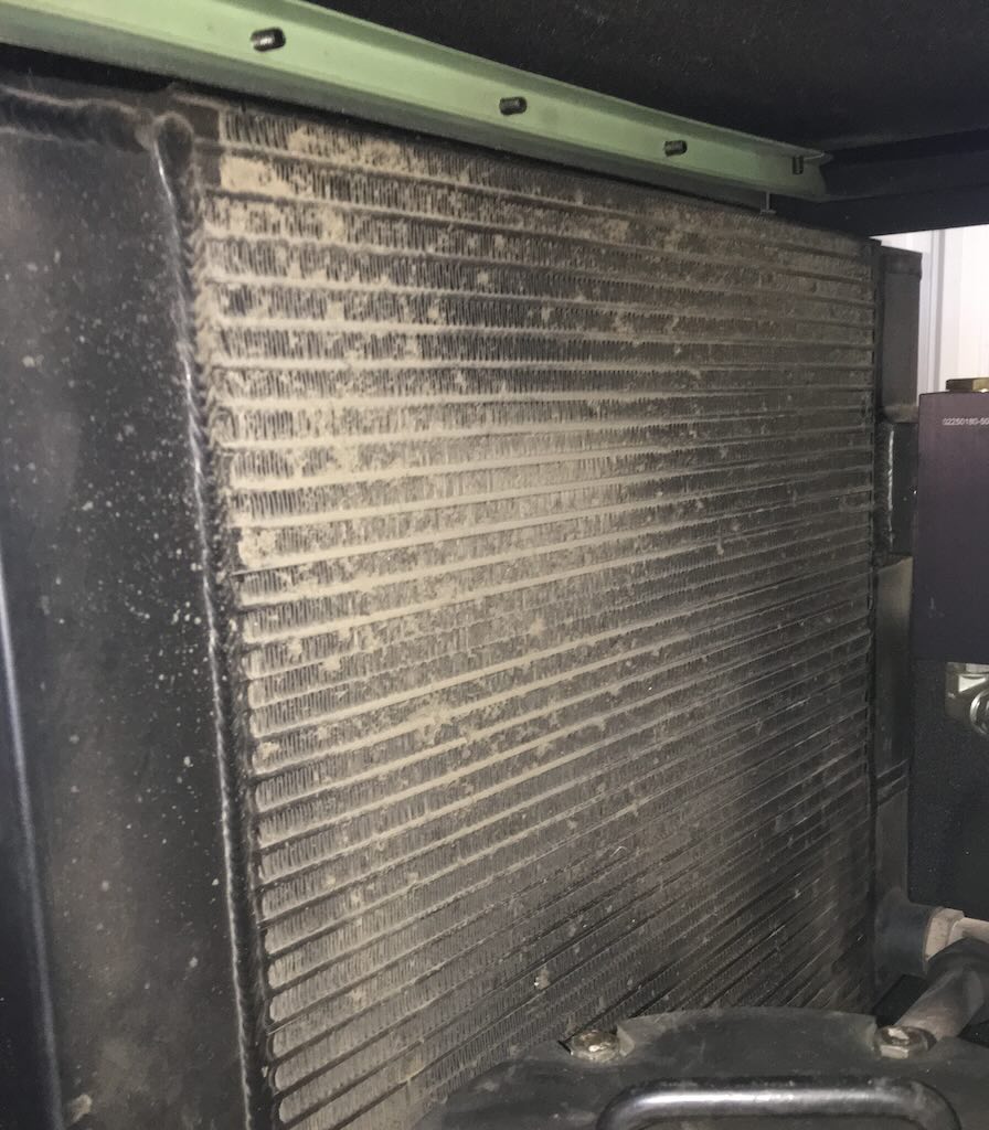

While attending to the manufacturer’s prescribed maintenance items, the technician also will inspect other machine systems for proper operation. This is a great time to review the compressor cooling system for proper air or water flow and check operating temperatures to confirm proper operation. Regulators and control valves also should be inspected.

Figure 1: Dirty cooler filters are just one of many items checked by a compressed air service provider during regular maintenance visits.
Figure 1: Dirty cooler filters are just one of many items checked by a compressed air service provider during regular maintenance visits. Courtesy: Hitachi Global Air Power

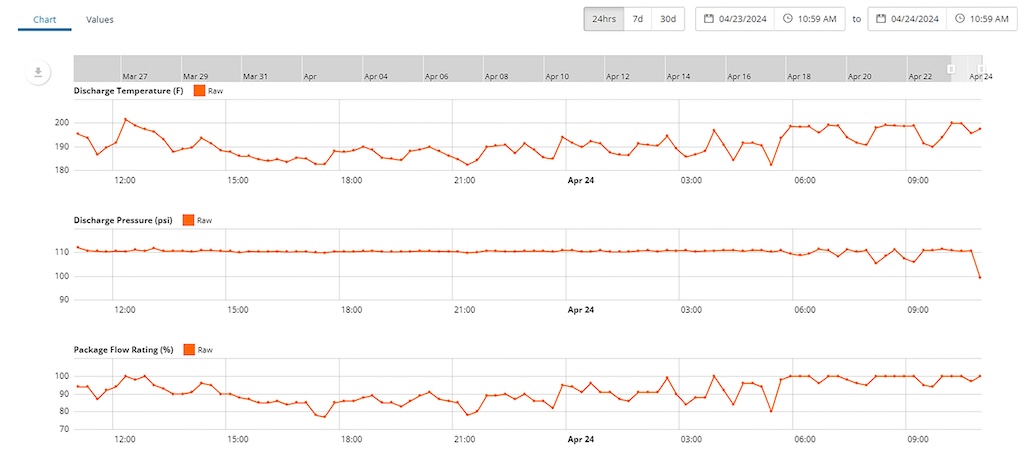

Compressor manufacturers recognize the importance of system monitoring and offer options to provide operators real time views of compressor performance — outside of a regular service call. Internet-based systems can transmit operating data to cloud-based systems that presents data for facilities technicians to monitor and review. These systems are often accessed through a portal maintained by the compressor manufacturer and can be packaged in with preventive maintenance agreements.
Modern production operations have the option to integrate building management systems to control systems and monitor critical operations. Compressor controllers can provide communication options through standard protocols such as Modbus and BACnet. By connecting to the compressor controller, systems integrators can provide plant management systems with information on compressor run status, maintenance alerts, warnings and faults and even offer remote start/stop controls in between service calls.
Using data to monitor trends and drive predictive maintenance
There are many data points that tell the overall story of the compressed air system, and various means by which those data points can be obtained (remote monitoring, vibration analysis and oil sampling). By analyzing this data and using the information to monitor and track trends, a technician can begin developing a predictive maintenance program to keep the compressor performing and avoid unplanned downtime.

Figure 2: Compressor data from internet-based monitoring systems such as run status, maintenance alerts, and faults all provide valuable insight into an air compressor’s health and performance.
Figure 2: Compressor data from internet-based monitoring systems such as run status, maintenance alerts, and faults all provide valuable insight into an air compressor’s health and performance. Courtesy: Hitachi Global Air Power

Compressors often operate in dusty or dirty conditions. Debris and other particles can accumulate on filters and heat exchangers, resulting in less efficient operation. In severe cases, air flow can become entirely obstructed. High operating temperatures can break down compressor fluids that lead to reduced fluid life and accumulate on heat sinks that increase operating temperatures of electrical components. Compressors should be monitored for consistent temperatures in range of the manufacturer guidelines. When temperatures start to rise, it’s time to inspect the fluid levels, heat exchangers, thermostatic valves and package filtration.

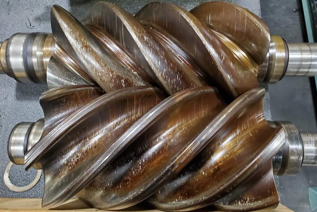

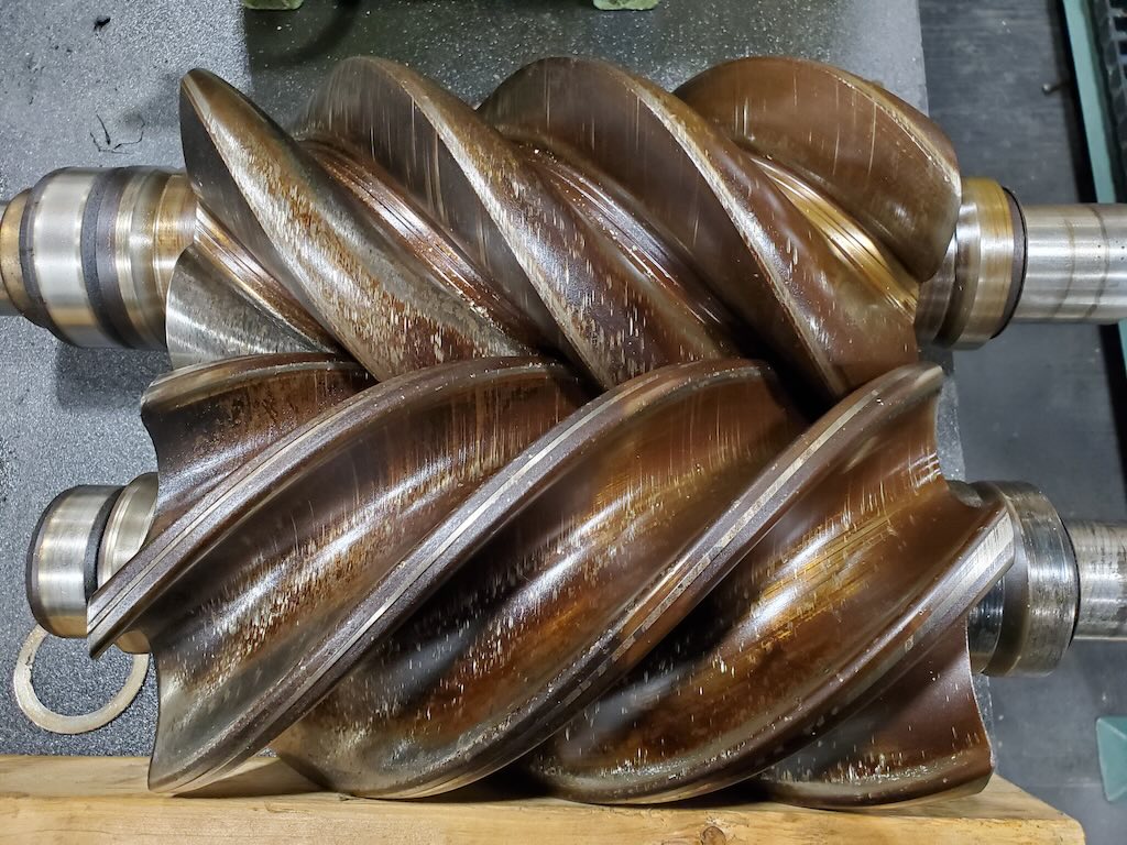

Figure 3: Using the wrong aftermarket products and failing to have a compressed air system regularly maintained from service professionals can cause damage to the compressor’s air end and to the overall system.
Figure 3: Using the wrong aftermarket products and failing to have a compressed air system regularly maintained from service professionals can cause damage to the compressor’s air end and to the overall system. Courtesy: Hitachi Global Air Power
