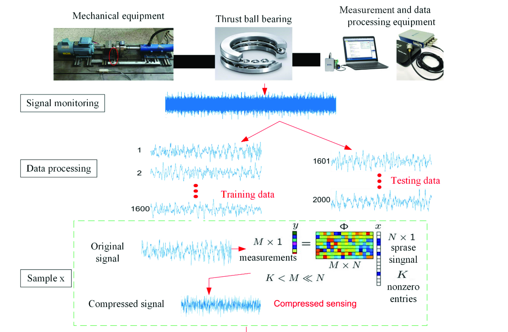

Figure 1: Onboard sensors signal unusual vibration patterns that can indicate when a bearing is beginning to fail. Figure courtesy of Jinyi Tai, J., et al. (June 2022), “Mathematical biosciences and engineering: MBE,” 19 (8), pp. 8057-8080, CC BY 4.0.
Sensors on the compressors reported multiple bearing temperature readouts, ball mill sensors reported simple one-dimensional average vibration readings and various electrical sensors reported voltages and currents (see Figure 1). Because the predictive analytics setup was already well established, Benning said, “It was no big problem to put another sensor on any piece of equipment.”

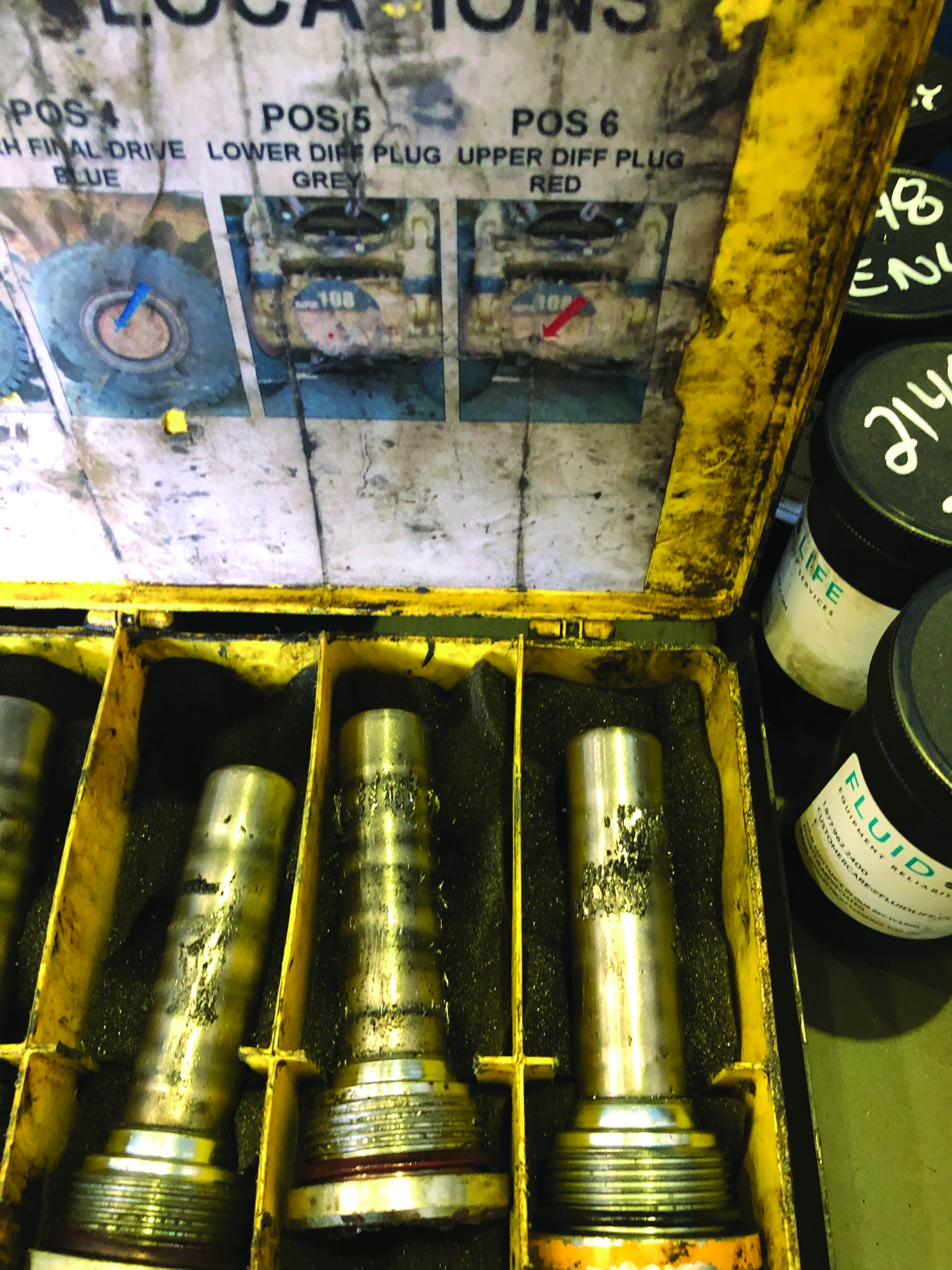

Maccan explained that they use lubricating oil condition monitoring based on laboratory analysis of oil samples and inspection of magnetic debris captured by magnetic plugs in the oil stream (see Figure 2). Periodic engine oil changes for their heavy, off-road vehicles are scheduled based on past experience, he said.
Figure 2. Magnetic plugs in the oil stream of heavy, off-road vehicles capture magnetic debris for laboratory analysis. Courtesy of Jory Maccan, Imperial/STLE
“We run fairly consistently with the number of hours that we put on at a time,” he explains, “so we have a really good idea where our engine oil is going to break down.”
Previous testing, in which drain intervals were gradually increased, established how long it took for the oil to develop acidity and load with combustion byproducts. This information was used to establish a safe zone for scheduling an oil change, he said, but changing to a different type of oil would require repeating this testing.
