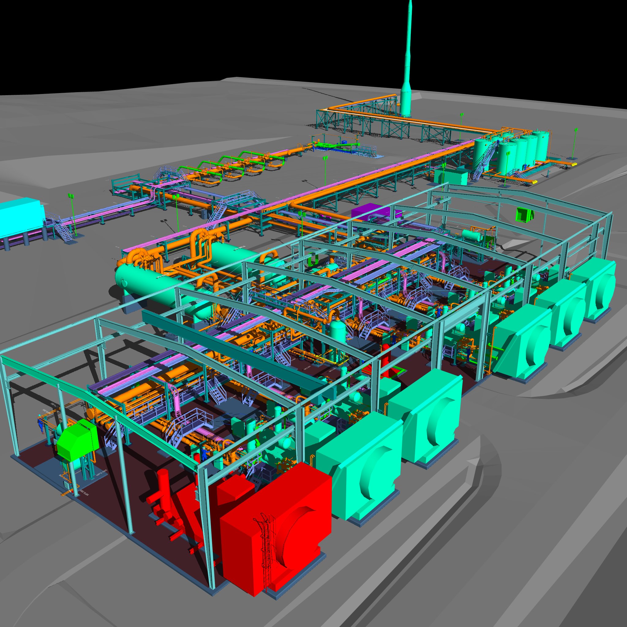

Figure 3: A 3D model of a completely new installment. Anvil Corp.

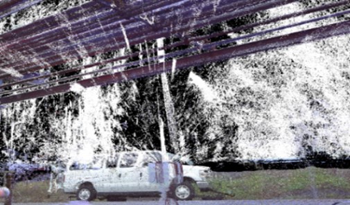

Challenge 2: Adverse weather conditions
Condensation in the air, such as rain, hail, snow, fog or even steam, distort laser scanned images captured in the field. Although water- and dust-resistant, laser scanners still pick up anything they see.
Whether a smudged image from water droplets on laser scan lens, solid condensates from snow or hail that distort light or fuzzy images from reflective and fast-falling rain, precipitation distorts the air and blocks laser scan targets, resulting in inaccurate and unusable scans (see Figure 4).
Figure 4: Distortion caused by rain and high humidity. Courtesy: Anvil Corp.
