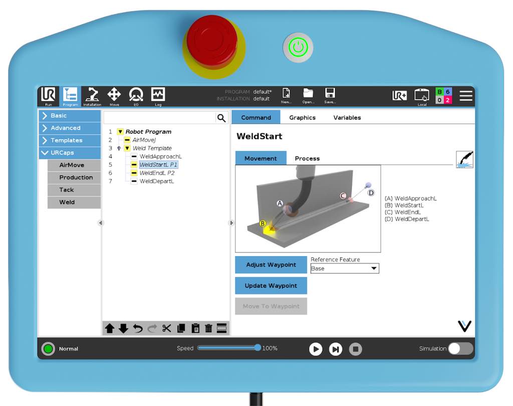

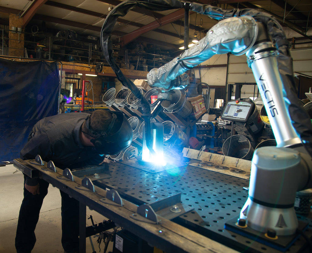

A collaborative robot welding application kit brings seamless plug-and-play functionality to the shop floor. Courtesy: Universal Robots/Association for Advancing Automation (A3)
Applications span everything from finishing, quality inspection and machine tending, to material removal, welding, assembly, dispensing and material handling. These do-it-yourself (DIY) kits bring what the Universal Robots team likes to call “plug-and-produce” functionality to very path-oriented, often complex applications. Take welding as an example.
Users don’t have to be a robot programmer to use the Vectis Cobot Welding Tool. Watch this UR+ Application Kit on the job at a solar energy equipment supplier.
“The best thing about the system is that you don’t have to be a rocket scientist to use it,” said Mike Gillin, a certified welder and operations manager at MT Solar. “I’m a welder by trade, but I didn’t know anything about robots, and I’m not very computer-savvy. Curiosity attracted me to the robot and I was really surprised at how easy it was to figure it out.”
The Vectis Cobot Welder arrives as a ready-to-weld package. The system includes a 10 kg UR cobot and an intuitive programming pendant loaded with weld libraries and tools. Users can “teach” the cobot by moving the articulated arm to program points. The DIY system also includes an air-cooled welding torch, a starter fixturing set and a wire feeder. Mounted on a mobile cart, the cobot welder requires no anchoring and is ready for work anywhere on the shop floor.
“This is a system that I can rent or lease for a very short period. If it doesn’t work out, I’m not saddled with the thing,” said MT Solar president Travis Jordan. “That made it really easy for us to get started.”
“The beauty of these systems is not just the functionality of the UR+ product,” Campbell said, “but also the ability to control it, set it up and program it completely from the UR+ teach pendant.”
UR Caps is the software module behind this functionality. It works as a plugin to the UR operating system called Polyscope. The company likes to say ‘UR Caps is to robots what apps are to smartphones.’
How does it work? The UR+ product is delivered with a USB stick containing the UR Caps software plugin for a particular product or application kit. For a UR+ gripper, for example, users connect the gripper to the UR robot. Then the UR Caps plugin is uploaded from the USB stick via a port on the side of the robot teach pendant. At that point, the robot controller recognizes the brand of the mounted gripper, the size and model, and how it’s actuated. According to Campbell, it’s that simple.
Intuitive user interface directly integrated to the robot teach pendant enables users with no robotic experience to program the welding system. Courtesy: Universal Robots/Association for Advancing Automation (A3)

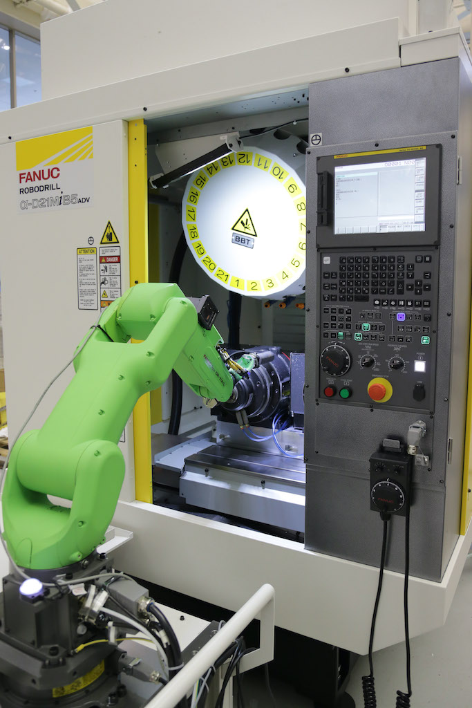

Where robots and CNCs meet
Many equate the FANUC name with robots thanks to their large yellow robots, but FANUC’s history as a producer of computer numerical controls (CNCs) dates back to the 1970s.
Even with robots and CNCs manufactured under the same virtual roof for decades, only now with FANUC’s new ecosystem, are the two technologies finally shaking hands. The new platform is called Quick and Simple Startup of Robotization (QSSR).
Worker shortages around the globe and growing interest in automaton have raised the demand for robotic machine tending of CNC machines. Until recently, FANUC robots could not “talk” to FANUC CNCs. There was no easy connection.
The challenge was getting robot language to communicate with G-code, the software programming language used for CNC machines. That’s where QSSR comes in. Emphasis on quick and simple. With one cable connection and some quick setup on either end, users could have a robot talking with the CNC machine. Better yet, users don’t have to be bilingual to do it. Operators fluent in CNCs don’t need to know robot programming to hit the ground running.
New ecosystem connects robots to CNCs for plug-and-play robotic machine tending without the need for robotics programming expertise. Courtesy: FANUC America Corporation/Association for Advancing Automation (A3)
“With QSSR, because a lot of the configuration and I/O exchange is done in the background, the communications and everything is put together for you, so it’s quite a reduction in the amount of time it will take an end user to automate a CNC,” said Greg Buell, QSSR and machine tending applications senior engineer at FANUC America Corporation in Rochester Hills, Michigan. “QSSR reduces setup time by over 50%.”
Not fluent in robot? No problem.
“If you’re familiar with CNC and the path work, you can set this up on your own. That’s really the advantage of the QSSR,” Buell said. “Once you get all the parameters set on the CNC side, so the two systems are communicating, you will actually program the robot motion through the CNC. You don’t have to do any programming on the robot teach pendant itself.”
Faster, easier setup
If a users wants to automate loading and unloading of a CNC machine, the QSSR provides software for the CNC and the robot. Then it’s one Ethernet connection from the robot to the CNC and some quick set up on both sides.
On the robot side, it’s a quick Q&A guide on the teach pendant. On the CNC side, users set up parameters for the robot and then the two controllers are talking.
QSSR sets up an FL-net communications channel over ethernet. FL-net is an industrial network protocol that allows the FANUC robot and the CNC to communicate with each other over a standard ethernet cable.
Buell said the QSSR platform is plug and play. You don’t need an integrator or robot expert on staff to be able to automate a CNC machine tending application with a robot.

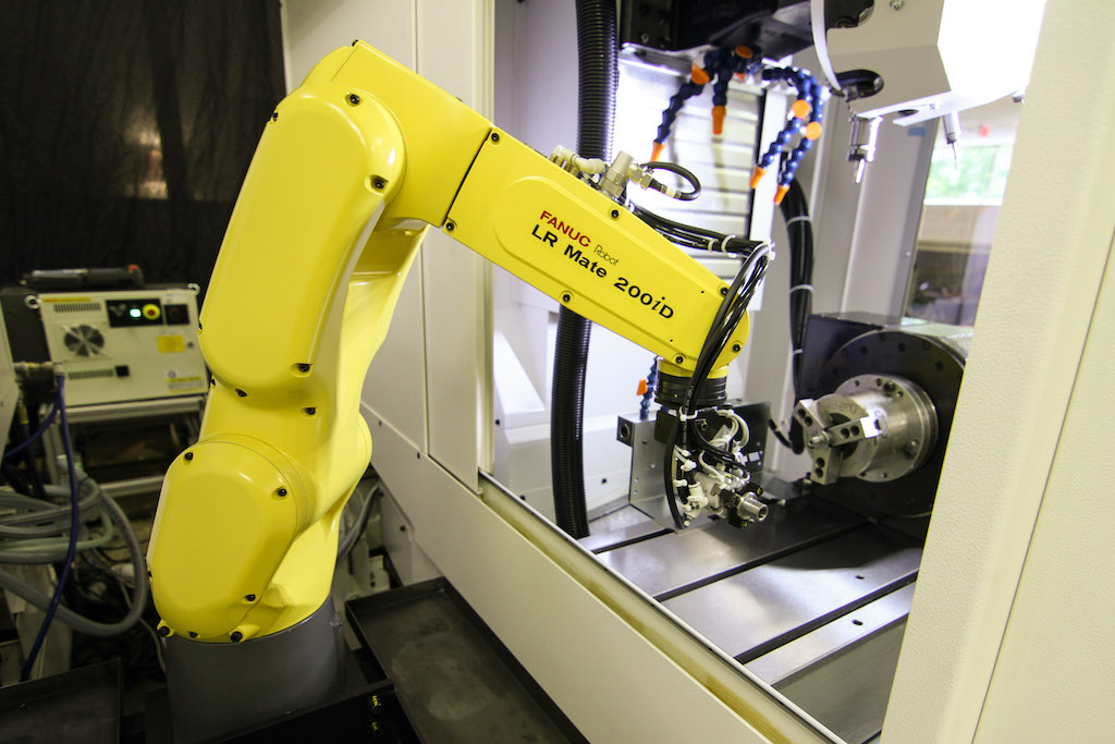

Integrating a collaborative robot to automate a CNC machine is quick and simple with a new communications protocol that allows the two systems to talk to each other. Courtesy: FANUC America Corporation/Association for Advancing Automation (A3)
Right now, the QSSR platform only works with FANUC robots and FANUC CNC-controlled machines. Applications include robotic loading and unloading of machine tools, including the FANUC ROBODRILL vertical machining center (pictured), ROBOSHOT injection molding machine, and other machines with FANUC controls on them. QSSR is compatible with any FANUC robot model, including the FANUC collaborative robots line (green robot pictured).
The FANUC collaborative robots line also has its own ecosystem of third-party peripherals and software to enhance the functionality of FANUC cobots. Similar to other cobot ecosystems, the controls for peripheral products are integrated into the robot teach pendant through a software plugin for easy setup and ease of use.
Take a peripheral third-party device like a gripper, add it to the cobot with the software plugin and then combine them with the QSSR ecosystem, and users have one easy setup solution for collaborative robot machine tending. Two ecosystems combine to make one plug-and-play automation solution for CNCs.

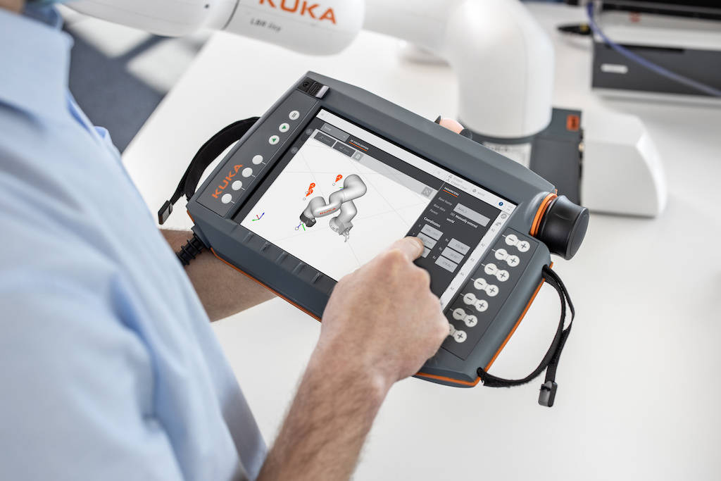

The 3 kg payload cobot is the first robot in the KUKA portfolio to run on the new operating system that powers the iiQKA Ecosystem and is the first in a family of cobots from KUKA. With Linux at its core, the new iiQKA.OS has a modular, open architecture with APIs (application programming interfaces) to deliver fast development and maximize ease of use for both newcomers to robotics and experienced users.
New collaborative robot is first in line for a fledgling ecosystem of hardware and software that will bring plug-and-play ease to robotic material handling and machine tending applications. Courtesy: KUKA Robotics/Association for Advancing Automation (A3)
“When you look at technologies like robotics, or any other sufficiently complicated type of hardware that traditionally takes a lot of skill, expertise, time and resources to implement, ecosystems have the opportunity to lower barriers to the point where anybody who wants a robot to do something, could do it,” said Nick Chambers, global manager iiQKA Communications & Ecosystem Business Development at KUKA Robotics in Augsburg, Germany. “We put a lot of effort into designing a subsystem that is future-proof and highly usable for customers and also external developers, whether they want to implement components such as grippers and vision systems, or some sort of software extension.”
The modular, open interfaces of the new OS not only make it easier for KUKA’s internal developers to implement new features faster and provide more rapid update cycles, but it also benefits third-party developers. They make it faster and less resource-intensive for developers to deliver their value on top of an iiQKA.OS-based system.
“When a customer buys and installs a SCHUNK gripper on the robot, it just works. This is because of our open interfaces and what we call toolboxes. It comes preconfigured, the safety is already there,” Chambers said. “Our goal is to not only allow people that have ideas for tasks they want to automate to get access to the ecosystem, but also make life much simpler for our existing experts, through improved workflows and easier implementation of external components.”

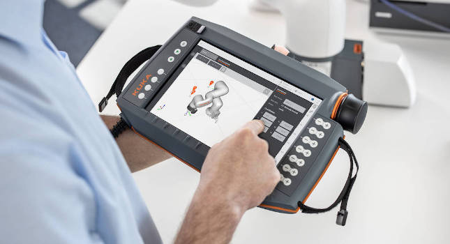

Chambers describes the gradual roll-out of the new ecosystem: In the first step, the iiQKA.OS provides a new graphical easy programming method called iiQKA.smart programming based on a program tree and collapsible nodes with intuitive functionality that’s powerful for experts and usable by newcomers to robotics, as well. When traditional six and four axis kinematics become supported by iiQKA.OS, the system will support programming in other modern programming languages, as well as KRL, KUKA’s existing robot programming language that has been in use for decades and has a large expert user base. When iiQKA.OS achieves functional parity with KSS within the next decade, KUKA will begin the phase out of KSS, the current main robot OS.
“We designed iiQKA to be easily migratable for KSS folks and also highly usable for people that don’t have a huge amount of expertise. We will also support new programming languages yet to be determined, for instance C++ or Python,” Chambers said. “That’s the flexibility of our system.”
Right now, the new cobot and operating system are available to select companies for testing and will expand in availability throughout 2021 and 2022. Global availability is expected by the end of 2022, with additional expansion into 2023.
The iiQKA Pre-Launch Package will ship with an optional SCHUNK Co-Act gripper preinstalled and preconfigured on the cobot for immediate use out of the box. The cobot is accompanied by the new smartPAD pro, which displays the redesigned and modern iiQKA user interface.
“We spent a ton of time thinking about how to make it easier to use,” Chambers said. “For instance, you can configure all your inputs and outputs and your safety right on the smartPAD in a very intuitive way.”
Access to a new robot ecosystem and operating environment is made easier with an intuitive user interface. Courtesy: KUKA Robotics/Association for Advancing Automation (A3)
