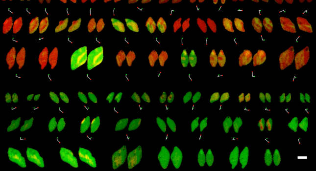

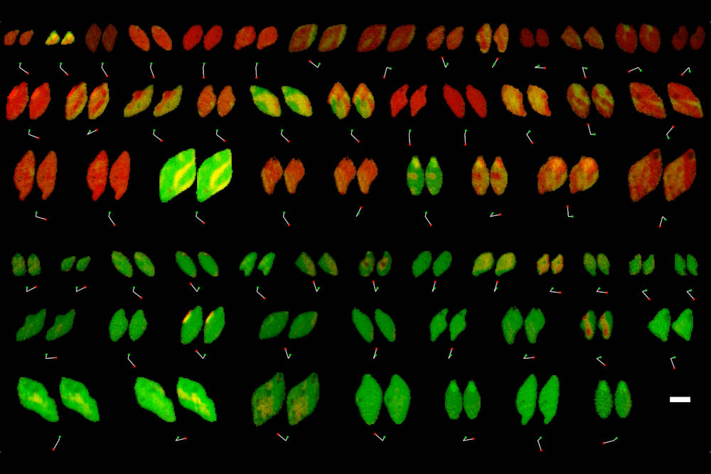

Researchers have observed how lithium ions flow through a battery interface, which could help engineers optimize the material’s design. Courtesy: Massachusetts Institute of Technology (MIT)
