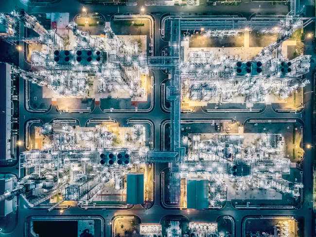

Petroleum Development Oman (PDO) is deploying technology to modernize and standardize the control system architecture of its Government Gas Plant (GGP) in northern Oman. PDO is the leading exploration and production company in the Sultanate of Oman.

Petroleum Development Oman is modernizing its Government Gas Plant in Northern Oman.
Petroleum Development Oman is modernizing its Government Gas Plant in Northern Oman. Courtesy: Honeywell
The installed solutions upgrade the gas plant’s supervisory control center. The scope of the overall technology upgrade includes moving all High-Performance Process Manager (HPM) controllers to a more efficient and sophisticated controller, the C300 and replacing the Fail Safe Controller with Safety Manager.
