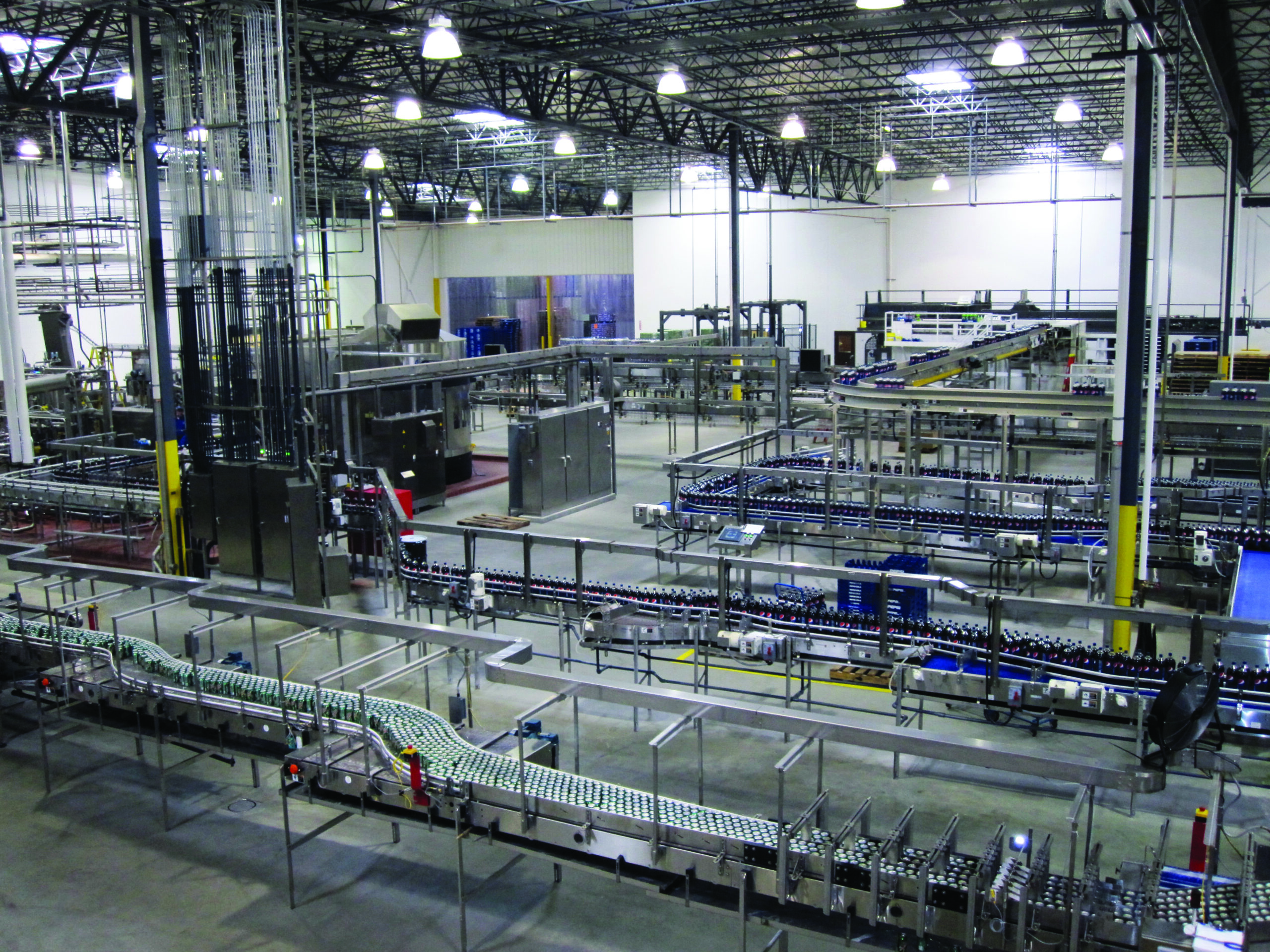

Pepsi Bottling Ventures (PBV), of Nampa, Id., was looking to optimize the process by which it manufactures and distributes more than 100 different flavors and brands. With such a wide variety of products, making smooth switches between formulations was central to the plant’s productivity, making changeover a key strategic metric. Prior to the optimization, engineers estimated that changeovers took 60 minutes.
Using analysis and visualization software, in this case Wonderware from Invensys, PBV  was able to identify the chief constraints and their root causes. Armed with this data, they determined that the most critical bottleneck was in the filler process. Addressing this issue improved changeovers by up to 45 minutes and resulted in additional savings in raw materials and packaging. Efficiency on the filler line increased 10%.
