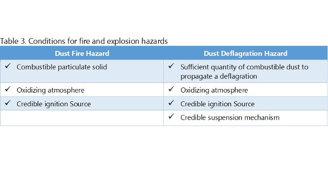

Table 3 summarizes the conditions for fire and explosion hazards in process systems, buildings or building compartments.
