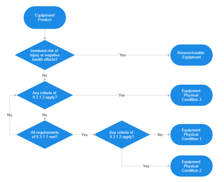

Figure 1: NFPA 70B: Standard for Electrical Maintenance equipment condition assessment flow chart. Courtesy: CDM Smith

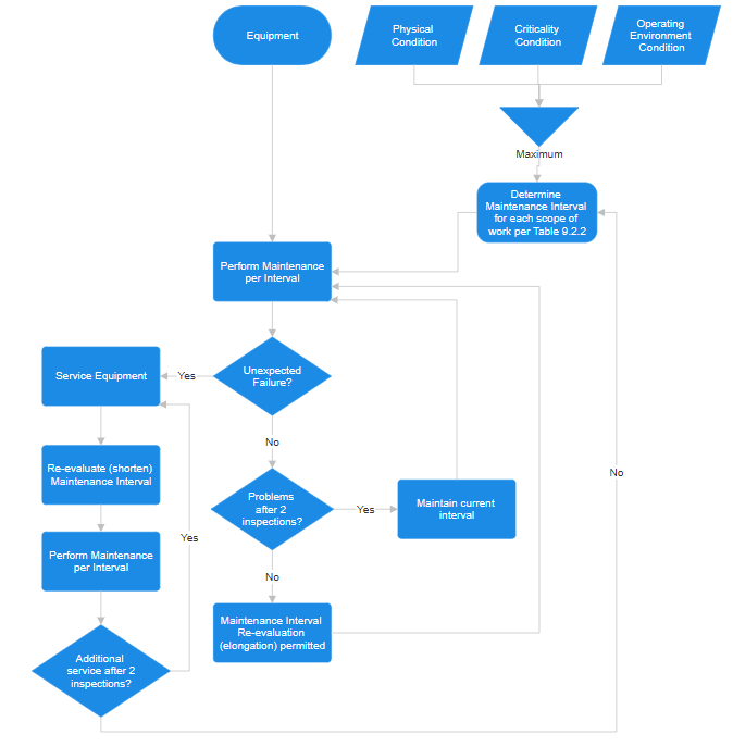

Figure 2: NFPA 70B: Standard for Electrical Maintenance interval flow chart. Courtesy: CDM Smith

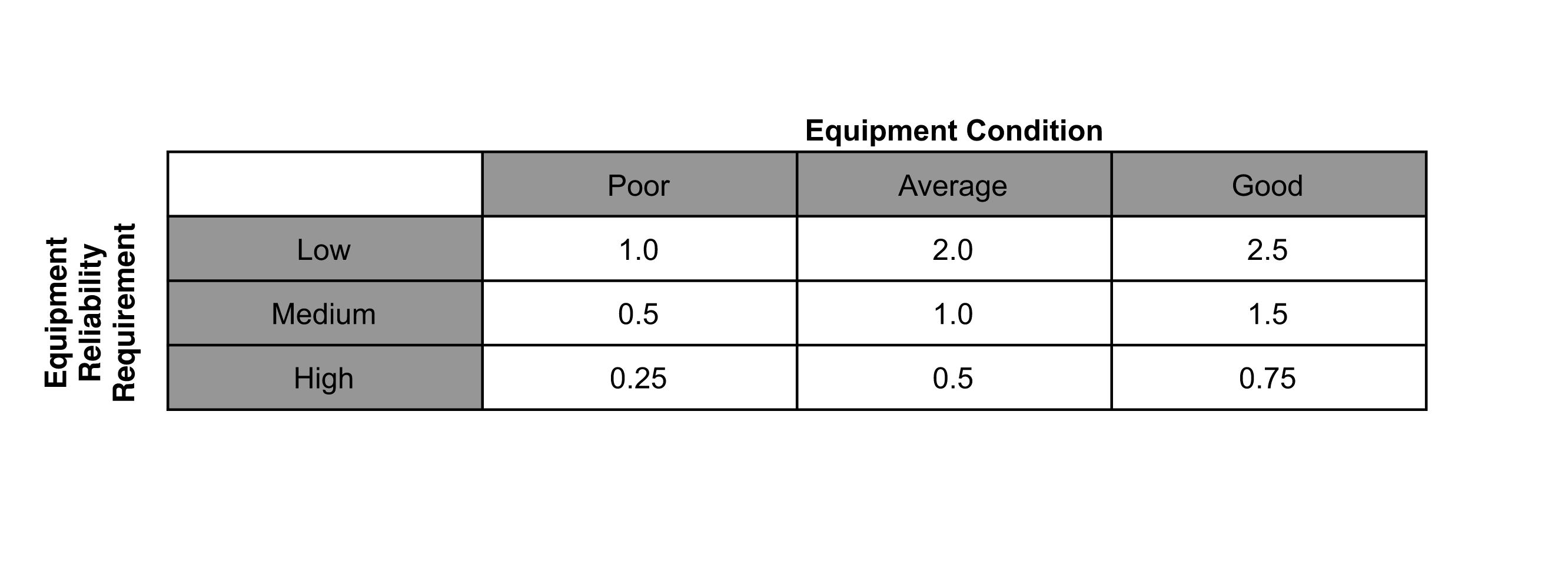

Figure 3: The NETA equipment reliability matrix found in Appendix B of ANSI/NETA. Courtesy: CDM Smith

Chapter 9 of NFPA 70B provides recommended intervals for electrical equipment maintenance first based upon manufacturer recommendations and afterward based on the condition assessment of the equipment. The condition assessment determines the recommended interval based on the worst of a given piece of equipment’s physical condition, criticality condition and operating environment condition.
  • Physical condition 1: Equipment appears in like-new condition, is clean, free from moisture intrusion and tight, has no unaddressed notifications or active recommendations and has been maintained according to the EMP.
  • Physical condition 2: Equipment is like physical condition 1, except that maintenance results might deviate from past results, there are issues requiring repair or replacement or there are active notifications or recommendations.
  • Physical condition 3: Equipment has missed the last two successive cycles required by the EMP, needs repair or replacement of major components or has active notifications or actions required.

Manufacturer’s recommendations supersede NFPA 70B recommendations. Intervals may be adjusted based on changing conditions and inspection results. Equipment that suffers unexpected failures might require more frequent servicing. Equipment that has completed more than two inspections without issues may have inspection intervals increased beyond Chapter 9 recommendations.

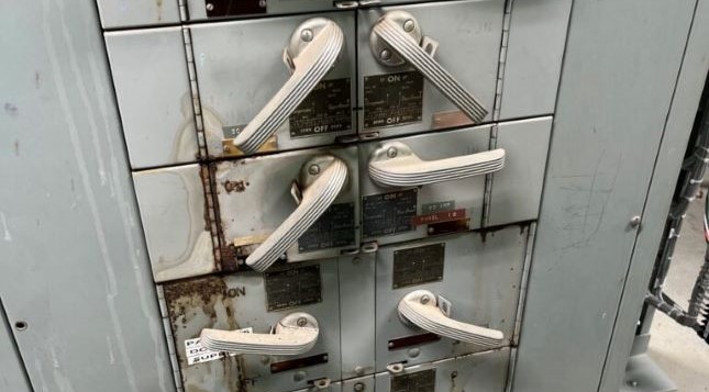

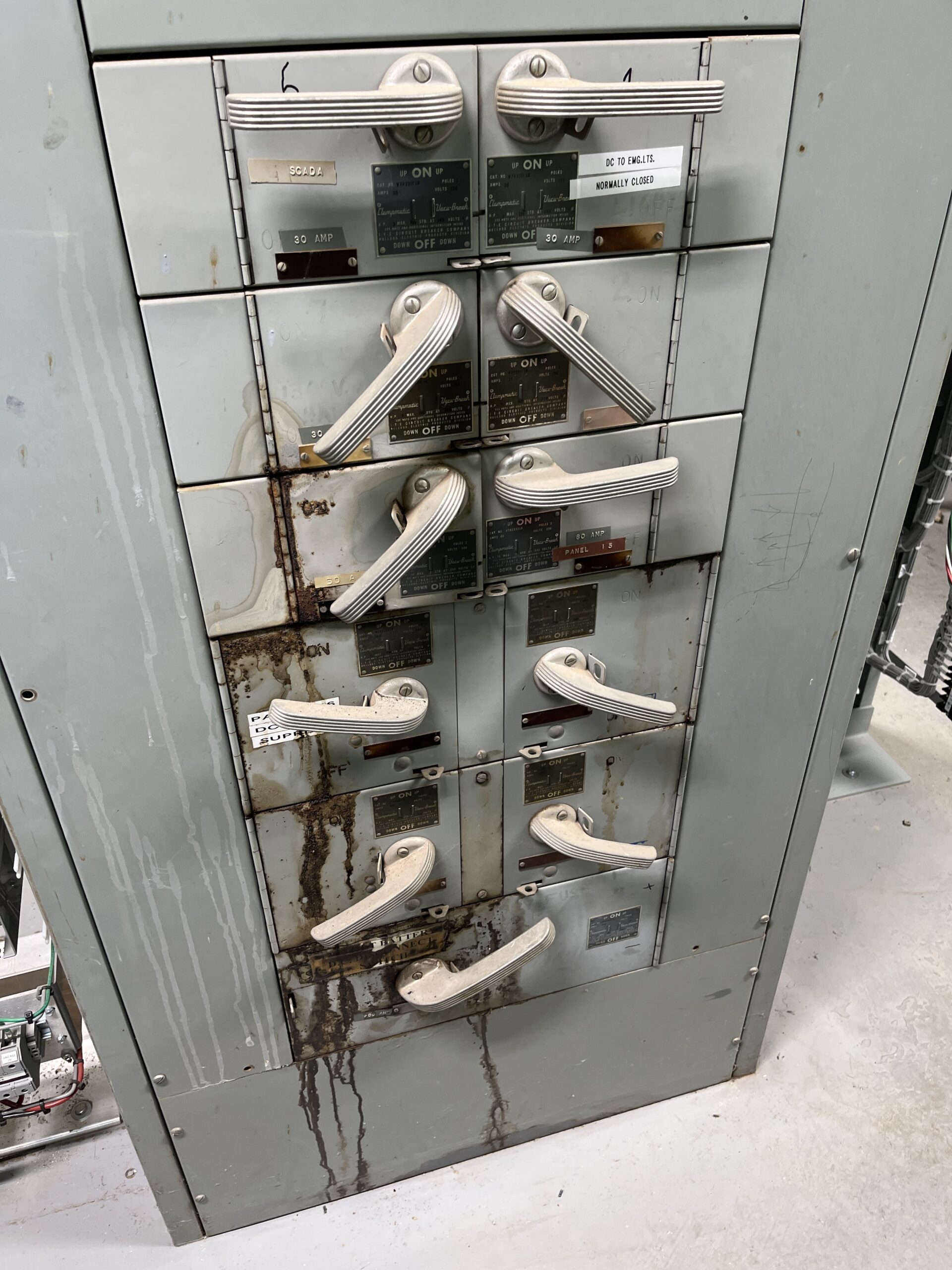

Figure 4: An example of damaged equipment due to lack of maintenance. Courtesy: CDM Smith

NETA’s guidance on maintenance intervals is detailed in Appendix B and labeled “Frequency of Maintenance Tests.” A table and matrix are provided. The “Maintenance Frequency Matrix” offers multiplication factors that should be applied to the table depending on the current equipment condition and required reliability rating (see Figure 1).
For example, when determining the recommended visual, mechanical and electrical maintenance test frequency for a small dry-type transformer, a base number of 36 months is gleaned from the table. If the transformer in question is determined to be in good condition but has a reliability requirement of “high” (e.g., a piece of a critical system), the matrix provides a multiplication factor of 0.75. This factor times the 36 months base number means the recommended frequency of full maintenance tests is every 27 months.
