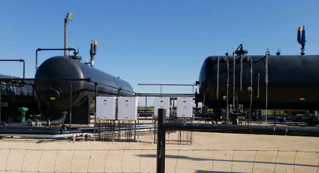

Midstream and upstream elements are often operated remotely, introducing logistical challenges for adjusting their operation (Figure 1). Ideally, centrally located users would be able to effectively operate and maintain these remote assets, saving the expense of worker travel and improving safety, but traditional automation platforms may limit these possibilities.
