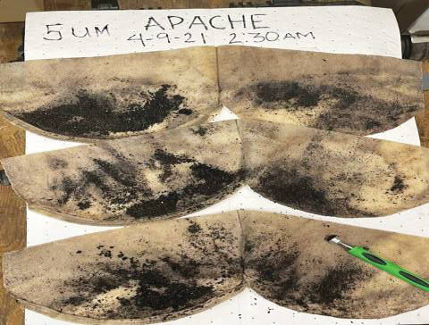

Photo 1: Carbon-containing metallic debris is visible on this steam turbine lube oil filter (39-inch, 5 micron) before the start of an 11-day system cleaning. Courtesy of Allied Oil & Supply, Inc.

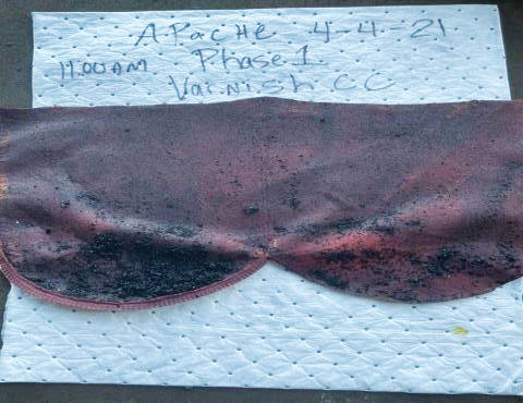

Photo 2: Oil filter after a five-day chemical clean. Varnish removal agent has discolored the filter, but the particulates are gone. Courtesy of Allied Oil & Supply, Inc.

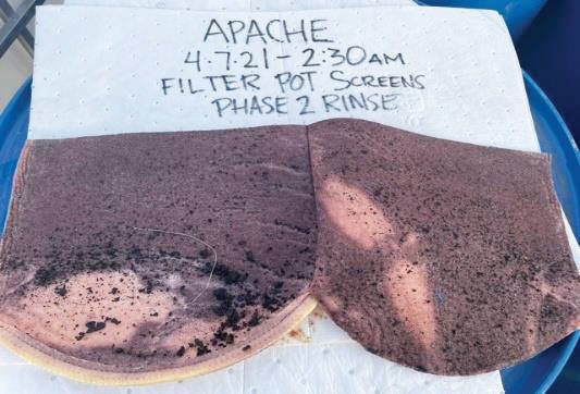

Photo 3: Rinsing the system with a neutral, compatible fluid removed the chemical cleaning agent. Then, a compressed air flush removed all fluids from the system. Courtesy of Allied Oil & Supply, Inc.

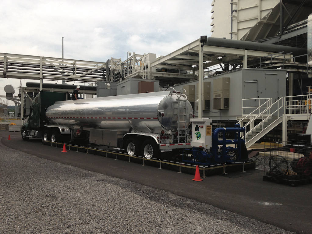

Figure 1: Pre-filtration unit (white box) between tanker truck and customer’s storage tank. Courtesy of Dilmar Oil Co., Inc.

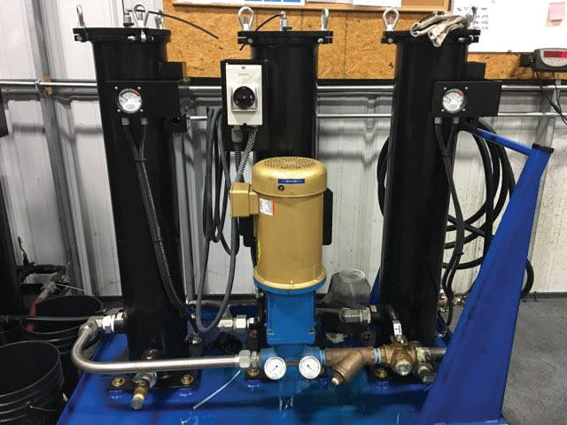

Figure 3: Three-stage filter cart. Courtesy of Allied Oil & Supply, Inc.
