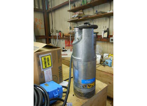

One major oil company has begun experimenting with SPGFCIs by installing a Littelfuse Shock Block SPGFCI in a mobile NEMA 3R enclosure that feeds 480 V, 3-phase power to a portable sump pump. This has eliminated the need to conduct an assured equipment grounding conductor program on the wiring for this piece of equipment, saving several hours of labor during each shutdown and freeing up qualified workers for other tasks.
A typical medium- to large-size refinery may devote 1 to 2 man-years on an assured equipment grounding conductor program. With a comparatively small investment in grounding devices, refineries and other plants having maintenance shutdowns may achieve considerable labor savings.
Managers will need to calculate the payback period by considering the number of temporary receptacles used with loads above 125 V, the number of SPGFIs needed to protect those receptacles, and the labor cost of inspections and documentation. SPGFIs may be reused for each shutdown and relocated if needed.
At this refinery, managers noted an additional benefit: compliance is automatic and does not depend on human behavior.
