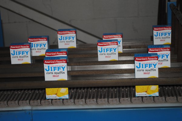

More than 1.5 million little blue boxes whiz through the Chelsea plant each day. Maintaining the maze of process lines for each of the 23 products keeps three shifts of workers busy.
“We measure success by uptime. Our goal is to attain the plan put before us based on what the sales guys say they need,” said Doug Weitting, maintenance department leader for Chelsea Milling. “We’ve achieved 100% plan attainment the last three years at least. Operations didn’t disappoint.”
