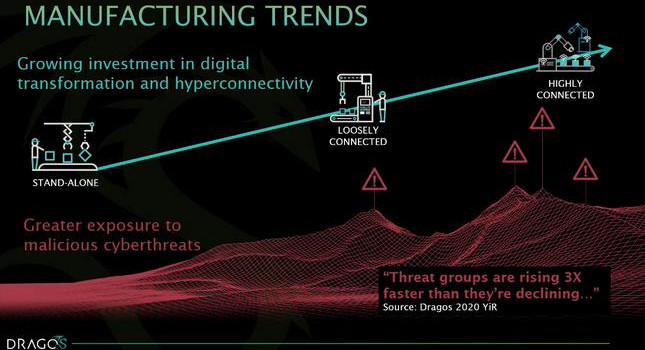

One of the trends Dragos has found is that improved connectivity makes systems more susceptible to cyberthreats. They have tracked different threat actor groups to see if there are any patterns to how they come into existence and then fade out. Good growth, in the threat landscape, would be having more groups fall off than arrive on the scene. When one group disappears, it would be manageable if only one to two groups replaced it. However, according to a Dragos study, “threat groups are rising three times faster than they’re declining,” which means when one group falls off, another three pop up.
