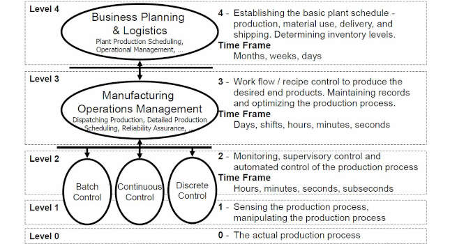

The ISA-95 Functional Hierarchy (ANSI/ISA, 2000) model was created by The International Society of Automation (ISA) to describe how manufacturing execution systems fit into the greater operational systems architecture (see Figure 1). This model can help to characterize the systems and data flows within our manufacturing business:
  • Level 0 represents the physical production process, where data moves in real-time.
  • Levels 1 and 2 are the process control and automation layer. At these levels data rates can span milliseconds to hours, representing real-time physical processes in timeframes that are easier for human operators to work with.
  • Level 3 is the MES/manufacturing operations management (MOM) layer, which is responsible for managing Levels 1-2 manufacturing systems and communications between plant floor and Level 4 business systems. Data timeframes range from seconds to days to convey data from business systems to manufacturing systems and vice-versa.
  • Level 4 contains business planning and logistics systems, like enterprise resource planning (ERP) and supply chain systems. These systems are used to connect production data to financial data for long-term planning, and work on a much larger timescale.
In this structure, MES/MOM (Level 3) systems are responsible for the management and control of processes that link the demands of the overall business to those of manufacturing. The ISA-95 standard models address MOM activities of production, quality, inventory and maintenance management and how these activity areas interact with business systems, automation systems, and among themselves.
