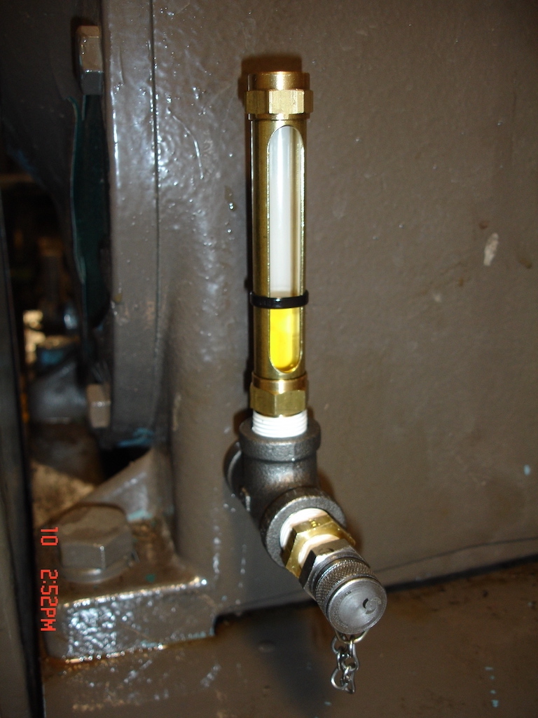

Sight glasses: Oil sight glasses work by giving a real-time snapshot of the oil inside machinery without having to shut anything down.
Figure 1: Progressive cavity pump gear drive. Courtesy: Upper Occoquan Service Authority
This live inside look plays a critical role in condition monitoring and early failure detection. There are some risks associated with dirty sight glass and leakage (visible and invisible), which may create some hidden failure modes.
Drawbacks include needing cleaning and replacement due to weather and sunlight or ultraviolet light, which can make level reading impossible.

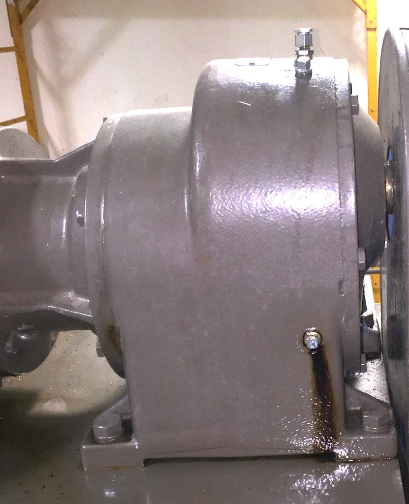

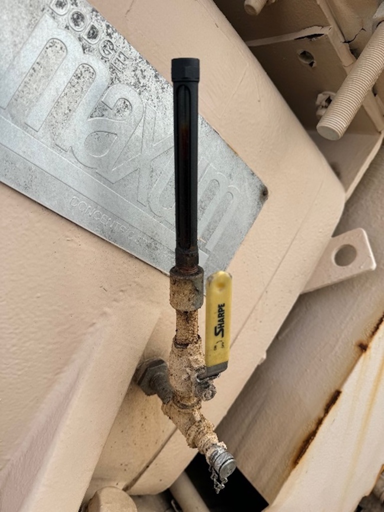

Oil level plugs: Oil level plugs (see Figure 3) enable oil level checks, but certain factors require attention. This option does not give a live inside look. Hidden oil leaks (invisible leaks) will not be detectable with oil level plugs until the plug is opened and the level is verified.
Figure 3: Progressive cavity pump gear drive. Courtesy: Upper Occoquan Service Authority

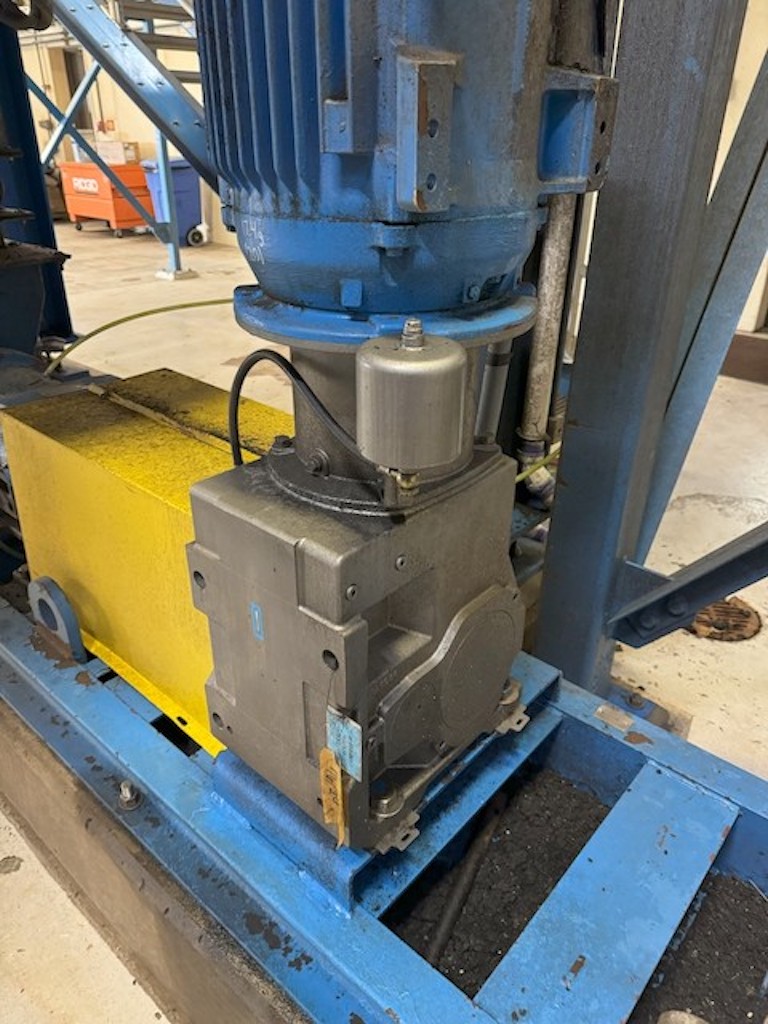

2. Increased oil churning or splashing losses and additional heating: This is for vertically mounted and horizontally designed gear reducers with the motor or input on top. They will need a higher oil level to ensure the lubrication of the first-stage gearing. These operating conditions result in increased oil churning or splashing losses and additional heating inside the gear unit. For these applications, it is critical to consider whether an accessory like oil expansion chamber is required.
Figure 5: Progressive cavity pump gear drive. Courtesy: Upper Occoquan Service Authority

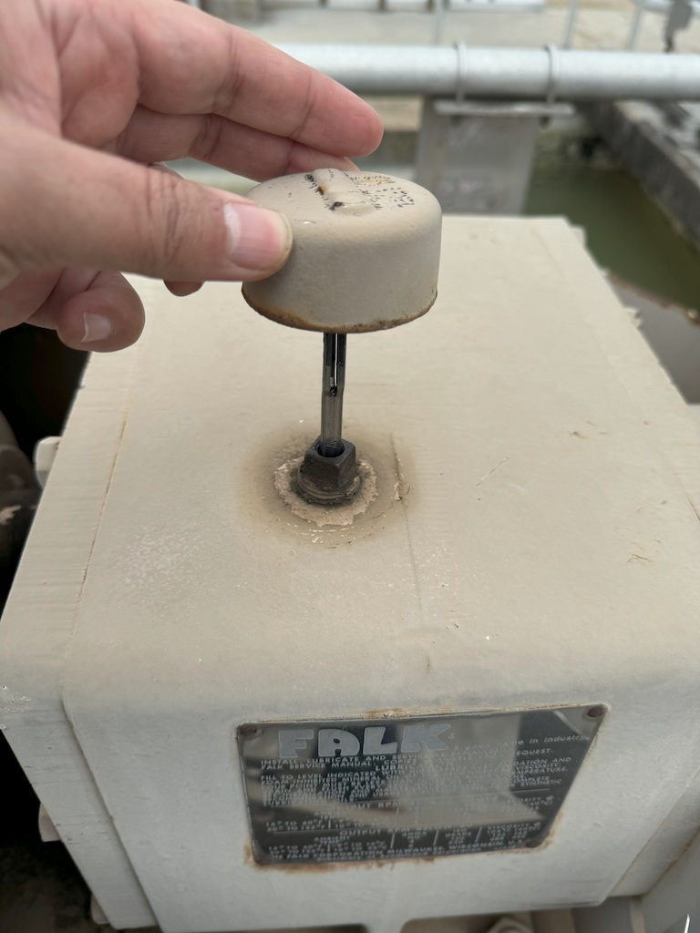

3. Ventilation: Many gear reducers come with a vent designed for the primary position to equalize air pressure variances between the gear unit’s interior and the surrounding atmosphere. Before starting the reducer, it’s crucial to ensure the vent is correctly positioned relative to the mounting orientation.

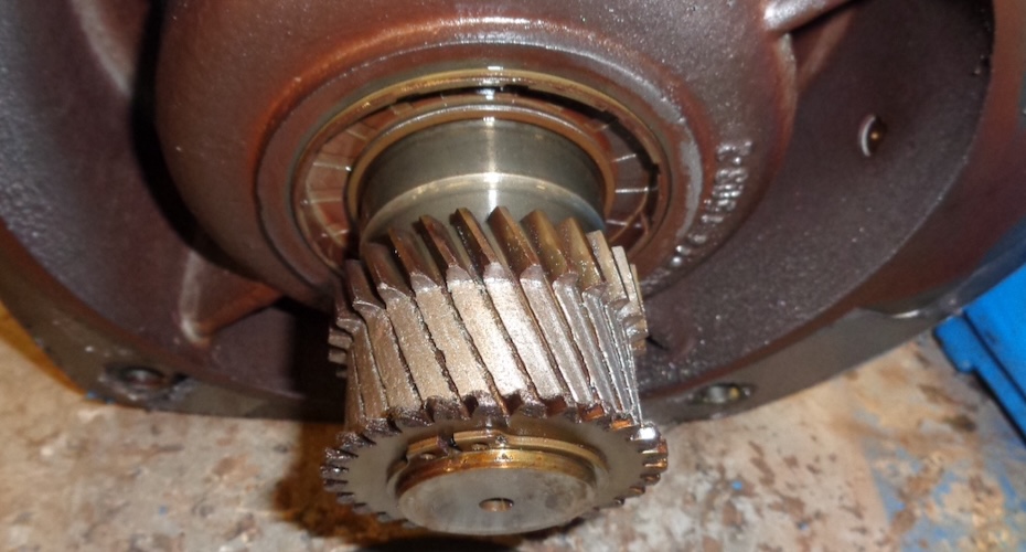

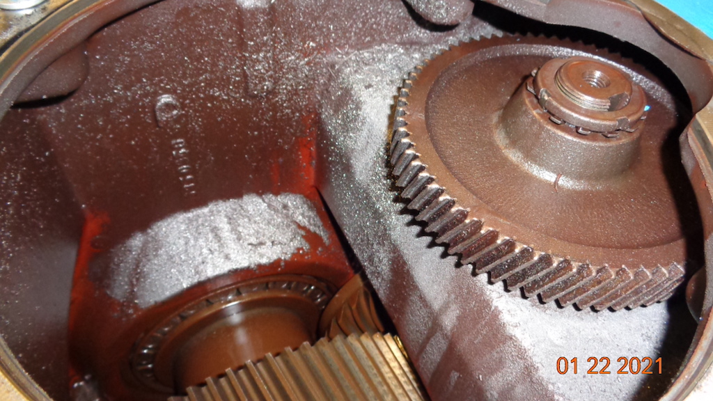

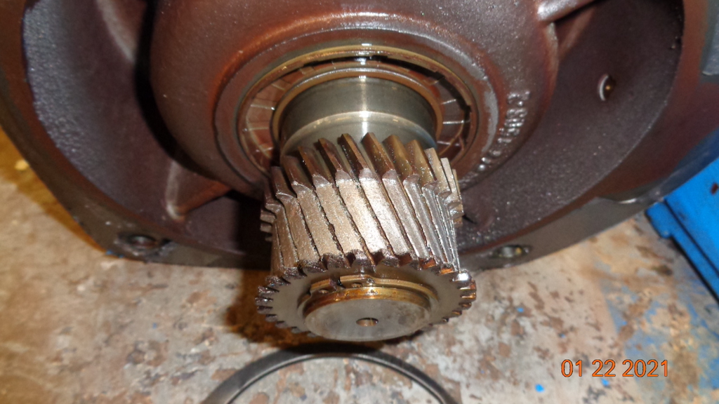

Possessing adequate knowledge of proper mounting techniques and optional accessories will enhance the gear drive’s reliability, inspection and monitoring. Insufficient lubrication can result in critical components like gears and bearings metal-to-metal contact leading to friction and eventually breakdown of these components and ultimately, gearbox premature failure.
Figures 6: Pinion gear failure due to low oil level. Courtesy: Upper Occoquan Service Authority
Figure 6: Pinion gear failure due to low oil level. Courtesy: Upper Occoquan Service Authority
Figures 7: Pinion gear failure due to low oil level. Courtesy: Upper Occoquan Service Authority
Figure 7: Pinion gear failure due to low oil level. Courtesy: Upper Occoquan Service Authority
Conversely, excessive oil can lead to thermal instability and may restrict space for thermal expansion during operation, thereby exerting excessive pressure on seals and causing them to fail.
