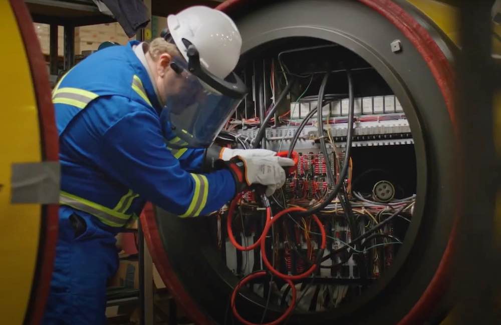

Jarred Richter wearing arc flash PPE. Courtesy: Hedgehog Technologies

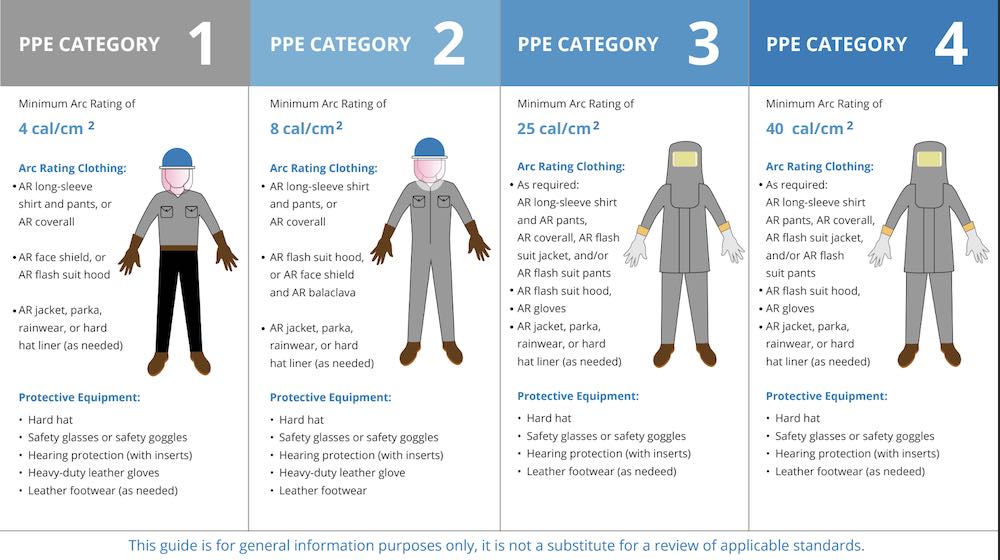

Chart representing the difference between four different PPE categories. Courtesy: Hedgehog Technologies
Using standards for verification
With those three pieces of information, verify them using relevant standards such as NFPA 70 (America), CSA Z462-21 (Canada) or IEEE 1584. These standards will support the decision in selecting PPE based on the incident energy levels.
For example, using CSA Z462-21 incident energy analysis will provide insight into the appropriate PPE from Table 3, 6A, and 6B. Once the PPE category is determined, refer to Table 6C which outlines the required PPE to be used.

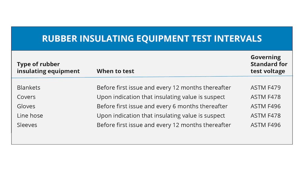

Example of an equipment testing interval with recommendations for inspection. Courtesy: Hedgehog Technologies
Prioritize buying arc flash gear that provides an acceptable fit for every team member. It’s pivotal to invest in multiple sizes because loose or tight-fitting equipment can become a safety risk. It is recommended all workers using arc flash PPE should have their own pair of flame-resistant coveralls, balaclava, approved safety footwear, safety glasses and hearing protection. Inspecting these items should become part of the regular maintenance routine to identify any potential risks. For example, parts of the arc flash equipment have a shelf life which requires inspection.
