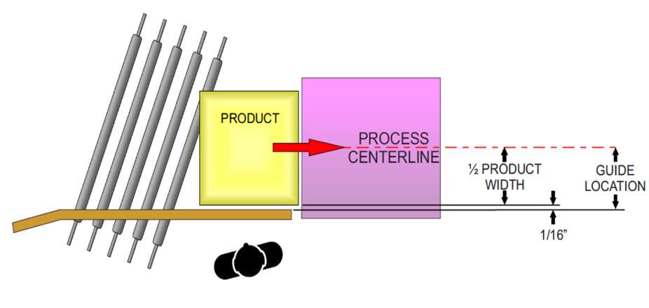

Many processes are designed to be balanced with respect to the product being produced. Examples include: punch presses, packaging, bagging, painting, welding and others. When conveying a product through a process, it’s best to bring the center of the product through the center of the process. I have seen those very products conveyed up to an inch off-center. It can be devastating to the flow. Therefore, we need to have a way to assure products are properly centered.
One way to do this is through conveyer guiding. My preference is to position a conveyer guide parallel to the direction of flow. The edge of the guide should be located using the center of the process, plus the width of the product and an additional 1/16”. This allows for product size variation. The conveyer rollers or belts should pull the product over to the guide and let it settle into place in a straight line, well before it enters the process:
I believe that it’s best to bring the product over to the “operator” side, so s/he can easily see what’s happening. Also, if we must adjust the guide location for different product sizes, it can be done from where the operator is naturally working, reducing effort and downtime. Once we establish ideal location(s) for the various product sizes, they should be made as error-proof as possible, using pins, marking, or other means for repeatability.
Finding the center of the process can be done with string or laser and two people. The human eye can see differences of <=1/8” over a 50-foot span, when focused and properly trained. Don’t forget to shut down and lock out the line when doing this work, which can take as much as one hour.

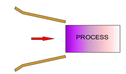

Many factories don’t use parallel guides and choose to use “funnel” guides that look as shown in figure 1.
The problem with this approach is the product can easily turn and doesn’t flow under control when it enters the process. Another problem is the end points of the funnel may create a pinch point, especially if the product has turned coming through the funnel. This can increase jams and downtime. Guides tend to wear down faster in this configuration and decrease the chance for the product to be properly positioned as it enters the process. You wouldn’t believe how many other engineers have challenged me on the removal of funnels. I guess being an industrial engineer didn’t give me the credibility I thought I deserved with my mechanical engineering friends. The results did, however. (See figure 2)

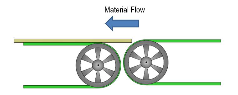

Make sure that the process is level side to side and then throughout the process that will be acting on the product. This isn’t always possible, as elevation changes might be required throughout the process. But, make sure critical areas are level front to back and side to side. Once the process levelness has been established, level the entry and exit conveyers to the process. Bring all conveyer transitions to 1/16” or less with respect to each other. If an elevation change is required between conveyers, make the prior conveyer higher than the next conveyer, to minimize corner or edge damage of the product (See figure 3).
