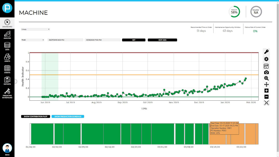

A unified machine dashboard for health, maintenance and other key metrics, derives and distributes an optimal maintenance schedule.
Maintenance and scheduling dashboard. It makes sense to combine production constraints and maintenance constraints in a single execution schedule.
Maintenance and scheduling dashboard. It makes sense to combine production constraints and maintenance constraints in a single execution schedule. Source: Predictronics

Enhancing predictive maintenance with predictive scheduling results in a unified dashboard showcasing machine health plotted against scheduled production orders. It also displays actionable information, such as when to order spare parts and when maintenance is required.
Through continuous machine monitoring, orders change from green to yellow as the urgency to replace or repair critical parts builds. With an integrated predictive maintenance and scheduling, maintenance not only uses machine health information to predict failure, but the team can now consider the risks of completing scheduled production orders versus accomplishing maintenance tasks.

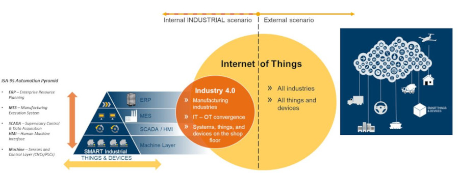

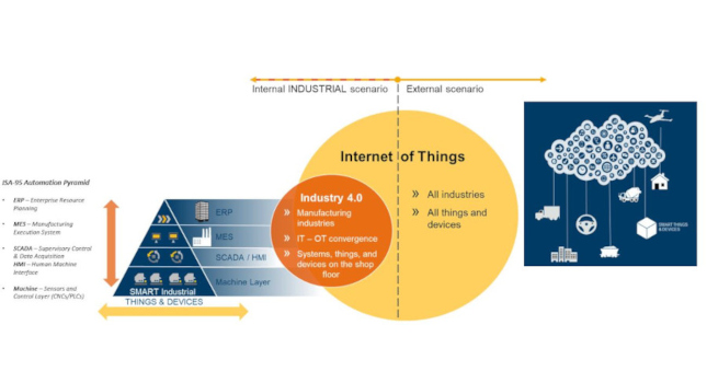

Think of the Industrial Internet of Things (IIoT) as the convergence of information technology (IT) and operational technology (OT). At the bottom of the pyramid are the shop-floor devices (CNC machine tools, welding robots, conveyors and more) able to convey data to the cloud. The next layer up is a supervisory control and data acquisition (SCADA) system for obtaining data from sensors or machine controllers. To engage the business, the data may be fed into a manufacturing execution system (MES) and the results shared with the enterprise resource planning (ERP) system to improve data capture and applied analytics.
The ISA-95 automation pyramid is a classification of software systems particular to manufacturing.
The ISA-95 automation pyramid is a classification of software systems particular to manufacturing. Source: Predictronics
