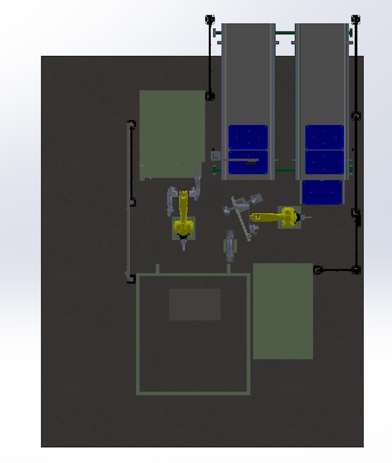

Figure 1: Plan view of the layout solution. Courtesy: Patti Engineering

A press station, a weld station and a laser station, which included some testing functions, were combined into a single automated cell.  The two robots were programmed to handle eight models of parts, with each model including additional variations.
  • Station #1 – Press station
  • Station #2 – Weld station
  • Station #3 – Laser marker with an additional test station.
The new robotic cell includes two automated conveyors, one infeed and one outfeed, with a third gravity-fed conveyor for empty bin collection. The first robot uses 3D vision to pick parts from a bin. Intermediary transfer stands were added for hand-off between the robots. The second robot tends the first two stations and uses 2D vision to pick the part. The first robot tends the third station. The first robot is also able to remove and add bins from the conveyors.
Safety fencing and a new control panel located outside the cell area were added to house the new controls hardware, including the cell control PLC, safety controls, and new interface for operators to interact with the cell.

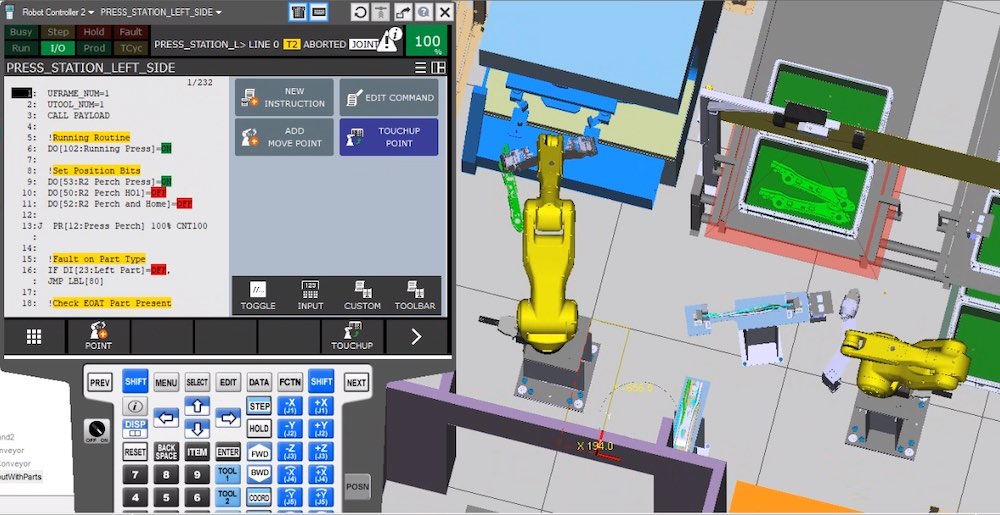

Figure 4: FANUC ROBOGUIDE is a programming and simulation software tool that reduces engineering time. Courtesy: Patti Engineering

Integrating the vision systems into the robotic cell required planning and precision. The team ensured seamless coordination between the 3D vision camera used by the first robot for picking parts from bins and the 2D vision capability of the second robot at the other machine stations. Implementing intermediary transfer stands to facilitate smooth hand-offs between the robots added to the complexity of the vision system integration.
To enhance visualization and streamline the development process, Patti Engineering used FANUC ROBOGUIDE, a simulation tool that allowed for thorough testing and optimization of system performance before physical implementation. Smooth, efficient commissioning of the automated cell was ensured.

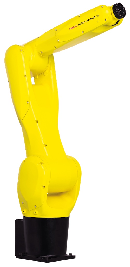

Figure 5: The FANUC LR-10iA Six Axis Industrial Robot. Courtesy: Patti Engineering
Product solutions selected
Working within the narrow existing footprint, FANUC’s LR-10iA 6-axis robot designed for machine tending and picking applications was chosen for a variety of reasons. At just over 100 pounds, the robot’s compact, lightweight design met the space limitations, arm reach, payload and speed needed, as well as being roughly the same cost as the robots the plant had originally specified. Attaching the robots to mobile platforms met the requirement of being able to return the cell to manual operation if needed.
