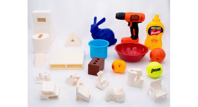

A University of Washington team created a new tool that can design a 3D-printable passive gripper and calculate the best path to pick up an object. The team tested this system on a suite of 22 objects — including a 3D-printed bunny, a doorstop-shaped wedge, a tennis ball and a drill. The designed grippers and paths were successful for 20 of the objects. Two of these were the wedge and a pyramid shape with a curved keyhole. Both shapes are challenging for multiple types of grippers to pick up.

A University of Washington team created a new tool that can design a 3D-printable passive gripper and calculate the best path to pick up an object. The researchers tested this system on a suite of 22 objects, which are shown here. Courtesy: University of Washington

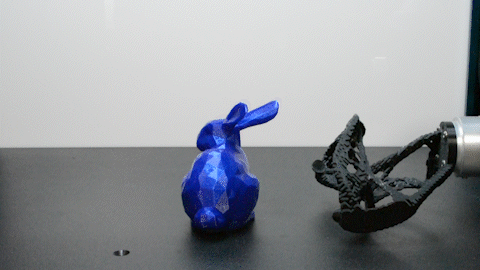

One of the objects was a blue 3D-printed bunny. Courtesy: University of Washington
When designing a new gripper and trajectory, the team starts by providing the computer with a 3D model of the object and its orientation in space — how it would be presented on a conveyor belt, for example.
“First our algorithm generates possible grasp configurations and ranks them based on stability and some other metrics,” Kodnongbua said. “Then it takes the best option and co-optimizes to find if an insert trajectory is possible. If it cannot find one, then it goes to the next grasp configuration on the list and tries to do the co-optimization again.”
Once the computer has found a good match, it outputs two sets of instructions: one for a 3D printer to create the gripper and one with the trajectory for the robot arm once the gripper is printed and attached.
The team chose a variety of objects to test the power of the method, including some from a data set of objects that are the standard for testing a robot’s ability to do manipulation tasks.
“We also designed objects that would be challenging for traditional grasping robots, such as objects with very shallow angles or objects with internal grasping — where you have to pick them up with the insertion of a key,” said co-author Ian Good, a UW doctoral student in the mechanical engineering department.
The researchers performed 10 test pickups with 22 shapes. For 16 shapes, all 10 pickups were successful. While most shapes had at least one successful pickup, two did not. These failures resulted from issues with the 3D models of the objects that were given to the computer. For one — a bowl — the model described the sides of the bowl as thinner than they were. For the other — an object that looks like a cup with an egg-shaped handle — the model did not have its correct orientation.
