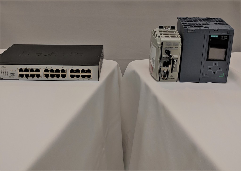

When an organization does not take advantage of potential synergies between information technology (IT) and operational technology (OT), it might be leaving plant floor systems open to attack. In many organizations, the lines of communication between these two groups are often nonexistent or strained, with each side ignoring the other or believing they are an obstacle to work around. Bridging this gap can improve performance on the floor and reduce risks to operations. A systems integrator is a natural facilitator to help make that happen (see Figure 1).

Figure 1: The gap between IT and OT can be overcome with the help of system integrators. Courtesy: Applied Control Engineering Inc.

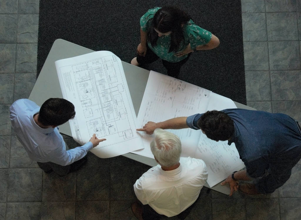

Network and infrastructure design: The plant network creates natural touch points between IT and OT groups and is another area where these teams and personnel should and need to work together (see Figure 3). This is obvious when looking at shared infrastructure such as firewalls and interconnections between networks. It may be less obvious when designing remote access techniques, authentication methods and strategies for encryption among other topics. These are areas where technology more familiar to IT teams can be used to improve the security and resiliency of OT systems and assets. Recently, at a cogeneration plant, the operations team was seeking to replace an existing balance of plant (BOP) plant floor network with a modern solution. A suitable programmable logic controller (PLC) original equipment manufacturer (OEM) ring topology was designed by the integrator, but only reusing a single existing upstream connection. Bringing IT into the process allowed them to suggest a design using existing virtual local area networks (VLANs) and resilient paths to two separate areas that integrated into their own resiliency architecture. In this case, successful collaboration between the teams brought the design above the original requirements.
Response planning: Incident response is a great area for discussion about shared responsibilities and planning, especially with the recent examples of ransomware shutting down operations. Even if the ransomware does not impact the operations networks, there may be actions that need to be taken to isolate the operations networks or even shut them down. The response to an incident is likely to be an “all-hands-on-deck” event, so planning the roles, responsibilities and potential actions in advance as a shared team can be a great way for all participants to understand how their part impacts the whole. We are doing this with a large steel manufacturer, bringing IT and OT experts together to improve the incident response and disaster recovery response to a potential ransomware attack.
