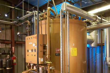

Thermal fluid heaters use an energy source to heat the fluid in a horizontal or vertical tank. Natural gas is often the fuel of choice because of its clean burning characteristics and attractive price. Units are available in a wide range of sizes, from 500,000 Btu/hour to 40 MMBtu/hour. Even larger process outputs are possible with multiple units. The working fluid is usually a high-temperature oil with a low oxidation characteristic and high heat transfer capability. In the unit design, it is important to keep the heated oil moving to avoid oxidation at the heat transfer point.
The heater itself is typically a gas-fired heat exchanger, with the circulating fluid passing through enclosed helical or serpentine coils in the combustion area. The heater is equipped with redundant temperature and pressure relays to prevent over-heating and to assure accurate delivery of the working fluid at the set temperature.

Thermal fluid heaters have found applications in a variety of markets, from asphalt processing to plastics manufacturing, from food and paper processing to the pharmaceutical industry. Ideal applications are where there is a need for controlled thermal input from a sealed system. One leader in fluid heaters is Fulton Thermal Corporation, headquartered in Pulaski, New York. Fulton offers both horizontal and vertical tank units in a wide range of sizes.
