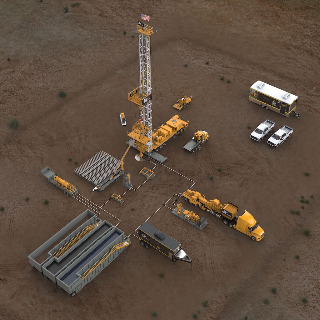

Mobile completion rigs
Some operators are mitigating these difficulties by using mobile completion rigs to remove the challenges of using CT for frac plug drill out operations.
An example is the high-spec rigs in operation by Ranger Energy Services (Ranger), a US-based provider of high-specification well-service rigs and associated services. These state-of-the-art rigs are equipped with 600 HP 300,000 lb. lifting capacity and mast heights up to 112 feet. Also involved are rig-assisted snubbing units with 600 – 2500 HP pumps, API-certified BOP stacks and 42-foot elevation pipe handlers with high-torque power swivels for maximum torque.
However, using the latest technology in mobile completion rigs has proved not to be enough to address the complex challenges inherent with completion in long horizontal wellbores. A comprehensive, total-integrated approach encompassing all facets of completion is required.
and snubbing. Courtesy: Ranger Energy Services
Figure 1: High-spec mobile completion platform for long-lateral frac plug drill out
