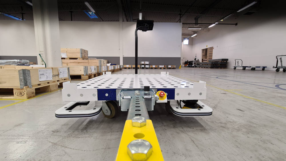

Flexible manufacturing requires a flexible material handling system that integrates artificial intelligence to improve its autonomy and flexibility. The main aim of a flexible material handling system is to compensate for the uncertainties within the shop floor. These uncertainties could be caused by increased demand, random machine failure, and inventory management shortfalls.
AGVs provide support for the different types of flexibility in a flexible manufacturing system, such as expansion flexibility, routing flexibility, and production flexibility. Such as when machine failure occurs, an AGV can reroute material transportation to only viable workstations in real-time.
Expansion flexibility is the area of flexible manufacturing that focuses on the capacity of a manufacturing facility. Expansion flexibility is required to ensure a facility can easily handle increased demand without any effects on product quality. AGVs support expansion flexibility in multiple ways, which reduce operational costs. One scenario is the ease at which its memory can be updated or modified to navigate new pathways in real-time. Another example is the ability to attach multiple tugger carts or pallets to AGVs to increase their load-carrying capacity to meet increased manufacturing capacity.
Production flexibility is also an important aspect of a flexible manufacturing system where multiple products or components are being produced within a factory floor. Workstations in product-flexible facilities are equipped with machines capable of handling multiple tasks and must be provided with diverse tools and materials to work with. AGVs support the application of production flexibility by automating the material handling process required to transport varying materials or tools to flexible workstations.
AGVs also serve as temporary storages to support just-in-time deliveries within FMS facilities. Without manual aid, AGVs can wait in a queue holding specific items within a distance of a workstation until the items are required. The AGVs’ ability to automate the queuing and just-in-time delivery process leads to improved machine utilization and increased productivity or throughput quality.
The safety aspect AGVs bring to flexible manufacturing systems with increased floor traffic cannot be overlooked. AGVs are equipped with safety features such as collision detection mechanisms.
