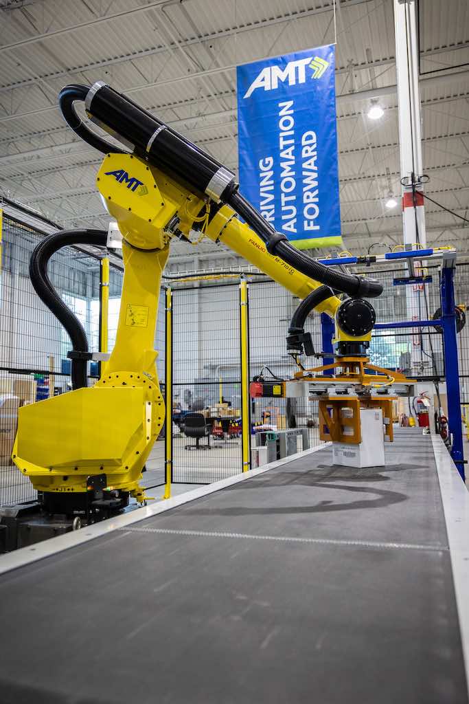

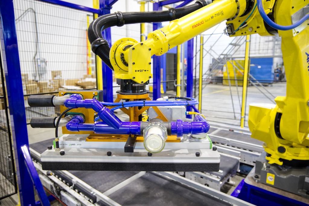

The robotic de-tray system was set up to receive trays of product (one-layer, homogenous SKU). A database supplied information about each tray, including the box length, width, height, weight and expected orientation, as well as how many rows and columns make up a single tray. Using an overhead 3D vision system and programmable logic controller (PLC) to find all the boxes on the tray and a custom algorithm to determine which boxes to pick up, the robot arm moves to the target boxes, uses a vacuum gripper to pick them up and moves to an outfeed lane to drop them off. Boxes must leave the machine in single file with their length along the conveyor flow direction.
The robotic layer forming system receives individual cases from a metered infeed conveyor lane along with a set of data describing each box. An overhead 2D camera finds each box on the conveyor as it comes in. Using an encoder that measures the motion of the conveyor belt, the robot moves a gripping tool around each incoming box, squeezes to hold it and moves it on the conveyor belt so that together with the other boxes on the conveyor, it will form a grid pattern at its destination.

After electing a percentage that the boxes needed to be overlapping to be considered aligned and can be picked together to find the group, came the calculations of where to put the foam pad. The objective is to land the edge of the foam right on the edge of the group, so that it only got the boxes that it wanted and no extras. When the group has been selected, the required location of the vacuum pad is determined, and the robot path is mapped from the boxes to the outfeed.
Several optimizations were employed to speed up the cycle time. These included using a lower resolution image with a sharpen filter, restricting the flexibility of the length/width dimension matching, lowering the density of the search, changing the exposure, and more. With these adjustments, the vision process was running at the required speed. To speed up the robot, the engineers wrote the program to limit the height of the robot arm to the minimum required for clearance. The proximity of the infeed and outfeed lanes plus the restricted robot movement meant that the cycle time could be met. A final customization to the program limited the allowable acceleration based on a box’s surface area, height and weight, preventing loss of vacuum on susceptible boxes.

On the layer forming system, an overhead 2D camera communicated with a PLC to find the box on the conveyor as it comes in, so the machine can handle boxes that aren’t aligned to a datum. The robot also uses an encoder that measures the motion of the conveyor belt. Using these devices and line tracking with an encoder to measure speed and movement, the robot moves a 7th axis gripper around each incoming box, squeezes to hold it, and then slides it along the belt. The robot puts each box in a position to form a grid pattern when collected at the end.
The full sequence is below:
  • Wait for the photo eye to see a box arriving.
  • Store the current encoder counts to remember where the belt was when the box arrived.
  • Trigger the overhead camera to take a picture and get the position/rotation of the box.
  • Wait for the belt to move far enough that the box is within the robot reach.
  • The robot meets the box, grabs it, and slides it into the final position while matching the conveyor belt speed.
Once the robot finishes a layer’s worth of boxes, it resets and starts over for the next layer. The data also indicates if a box is supposed to end up with its length aligned to the conveyor flow or turn 90 degrees. The robot can calculate all the moves at runtime with this amount of data.
To solve the speed issue, the engineers came up with the ingenious idea to use the conveyor’s incoming guide rail to best advantage.
The rail was referenced as a baseline location and three rows of boxes were placed in the proper position to form the required pattern at the end. Since one-third of the boxes came onto the conveyor properly positioned at the rail, only two-thirds needed to be moved, saving time and meeting the 1.1 second throughput requirement without putting the robot above its sustainable capacity.
