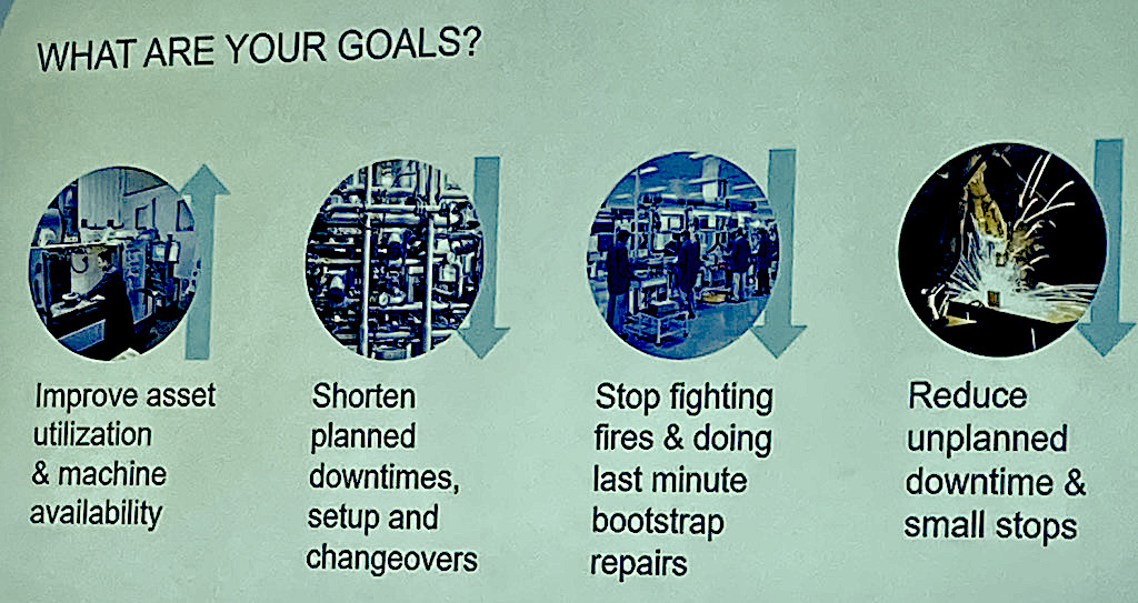

The four things companies should be asking before jumping headfirst into robotic welding automation are:
  1. Improve asset utilization and machine availability
  2. Shorten planned downtimes, setup and changeovers
  3. Stop fighting fires and doing last-minute bootstrap repairs
  4. Reduce unplanned downtime and small stops.
“Downtime is killing us in robotic welding.” Healy said. He cited a few sources saying that it can be anywhere from $17,000 per incident to $22,000 per minute in the automotive industry. He highlighted this by mentioning a car manufacturer that produces a new vehicle every 50 seconds. Working that out to an hour, that’s over $1 million this company would end up losing because a system went down.
Companies looking to improve operations should look at improve asset utilization and machine availability, shorten planned downtimes, stop doing last-minute bootstrap repairs and reduce unplanned downtime and small stops. Courtesy: Chris Vavra, CFE Media and Technology

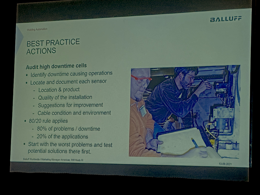

Step 1: Get started. No seriously, right now. Healy said the best place to start is with something small. Identify the most troublesome workcell and perform an audit. What area has the most downtime, quality issues and changeouts? After identifying this, go out and ask the operators and maintenance crews and gather as much data as possible.
“The data doesn’t have to be perfect,” Healy said. “and identifying them and getting a general idea of what is going wrong. Data provides answers and potential solutions and what’s causing problems, and why it is happening.”
Audit the troublesome workcells and document what is going wrong and how it can be fixed. Courtesy: Chris Vavra, CFE Media and Technology

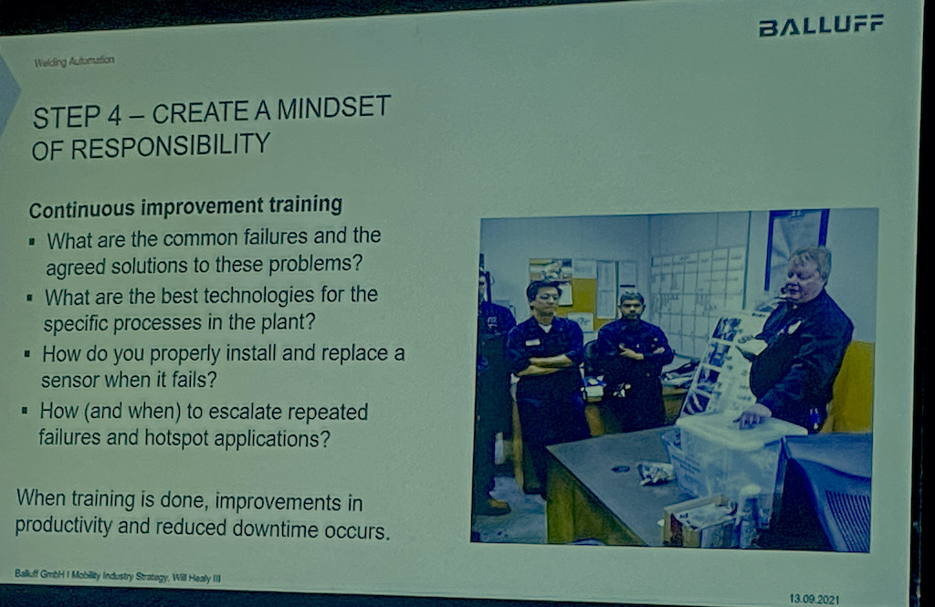

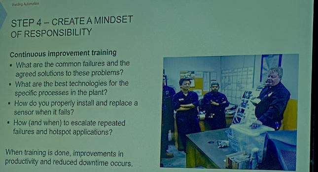

Step 4: Create a mindset of responsibility. Healy admitted this might be the hardest part of the process. It’s one thing to document the challenges and give recommendations, but implementing them and keeping it consistent is another matter. Workforce culture, particularly in engineering, is about consistency. Many of the practices established have become ingrained. Changing that won’t happen overnight.
Documenting the ROI in specific detail can help. This gives others a concrete idea of how severe the problem is and convince others of the value of changing protocols.
If there is a general agreement on making these culture changes, continuous improvement training can help manufacturers identify issues such as:
  • What are the common failures and agreed solutions to these problems?
  • What are the best technologies for specific processes in the plant?
  • How do you install and replace a sensor when it fails?
  • What is done to avoid repeated failures?
“For manufacturers who really embrace these steps, it does get better if you do it,” Healy said.
Creating a mindset of responsibility requires constant improvement on every level to make changes in the workplace culture. Courtesy: Chris Vavra, CFE Media and Technology
