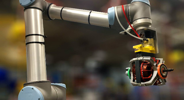

There are many different types of robotic grippers for specific applications.
Regardless of type, a robotic gripper should be flexible and easy to use and integrate.
Robotic grippers should also support long-term data integration goals.
