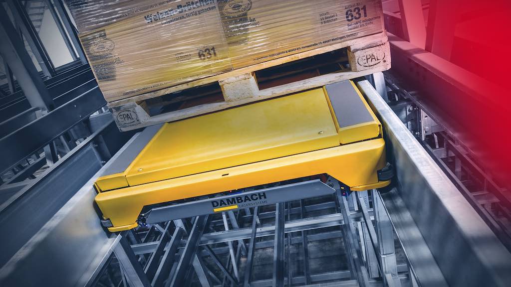

The Dambach Compact shuttle makes it possible to store and retrieve large load carriers in high-bay warehouse channels. It is extremely quick too: It takes less than two seconds to pick up or put down a load. Up to 1500 kg can be picked up and transported. In combination with stacker cranes or a transport vehicle, a particularly compact, multi-deep storage of pallets can be achieved.

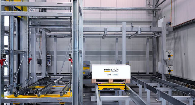

The storage channels are equipped with running profiles on which the shuttle moves. It travels precisely on the running profile to the specific storage area and then picks up or puts down the desired pallet. The storage and retrieval machine or transport vehicle then brings the shuttle to the relevant loading or unloading point in the warehouse.
