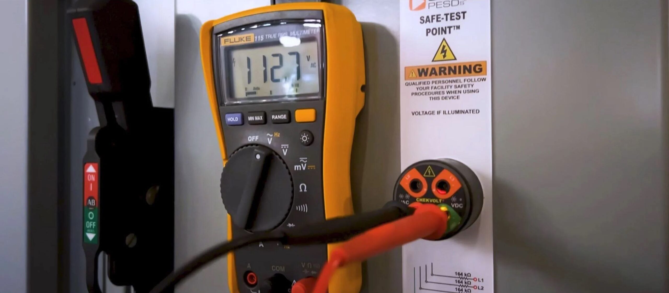

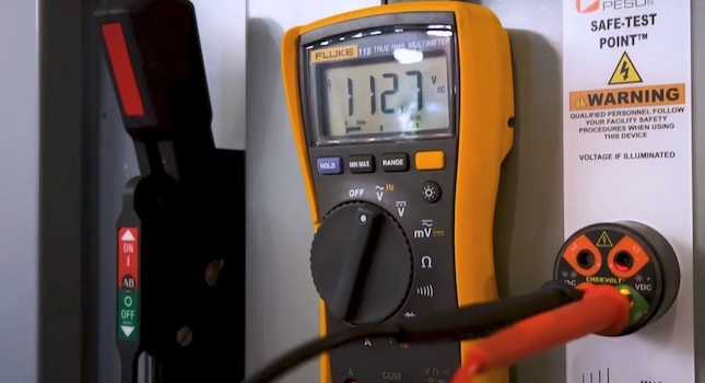

The role of a permanent electrical safety device (PESD)
When it comes to electrical safety, compliance with regulations is crucial. However, forward-thinking companies understand that going beyond mere compliance can significantly enhance both safety and productivity. The PESD offers innovative solutions to improve LOTO procedures. By installing this onto enclosures, companies can reduce LOTO procedure times, enable safer absence of voltage tests and mitigate hazardous electrical exposure risks. A PESD revolutionizes LOTO procedures, creating a safer and more efficient work environment.
  • Installing PESD onto enclosures reduces LOTO procedure times by 35-40 minutes.
  • ChekVolt allows a qualified electrician to perform absence of voltage tests safely and efficiently from the outside.
  • Hazardous electrical exposure risks are mitigated, enabling a single electrician to complete the procedure in less than 5 minutes.
