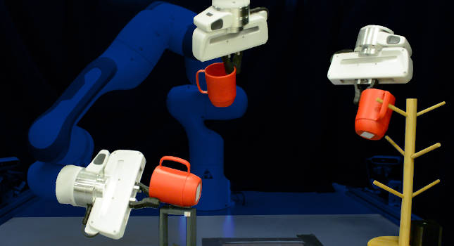

MIT researchers have developed a system that enables a robot to learn a new pick-and-place task based on only a handful of human examples. This could allow a human to reprogram a robot to grasp never-before-seen objects, presented in random poses, in about 15 minutes. Courtesy: Massachusetts Institute of Technology (MIT)

The researchers use this trained NDF model to teach a robot a new skill with only a few physical examples. They move the hand of the robot onto the part of an object they want it to grip, like the rim of a bowl or the handle of a mug, and record the locations of the fingertips.
Because the NDF has learned so much about 3D geometry and how to reconstruct shapes, it can infer the structure of a new shape, which enables the system to transfer the demonstrations to new objects in arbitrary poses, Du explains.

They tested their model in simulations and on a real robotic arm using mugs, bowls, and bottles as objects. Their method had a success rate of 85% on pick-and-place tasks with new objects in new orientations, while the best baseline was only able to achieve a success rate of 45%. Success means grasping a new object and placing it on a target location, like hanging mugs on a rack.
