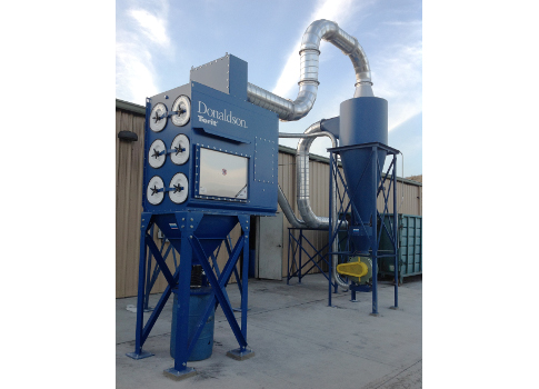

3. Consider involving resources beyond a design/build contractor or engineering company in the project.
Design/build contractors or engineering firms sometimes provide layouts for space without taking into consideration key industrial ventilation engineering principles and practices. As an example, the influence of inlet and outlet duct requirements on the performance of dust collection equipment is well understood by quality dust collector suppliers, but may not be evident to the engineering firm.
To ensure overall system performance, include a knowledgeable dust collector supplier along with the contractor or engineering firm in a thorough review of your project drawings. The dust collector supplier should be able to make recommendations on good industrial ventilation practices based on their experience with dust collection systems. Beyond just how the ducts are connected to their collector, a good collector supplier may be able to offer recommendations on subtle adjustments in ducts or hood design, which could improve overall system performance. And those types of recommendations represent changes that are much less expensive on paper than trying to optimize the system once it is all already installed.
Never forget that good inlet and outlet duct designs will improve long-term collector filter performance by increasing filter life and reducing filter maintenance requirements.
