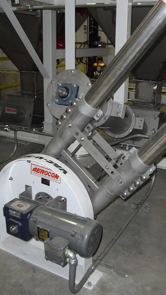

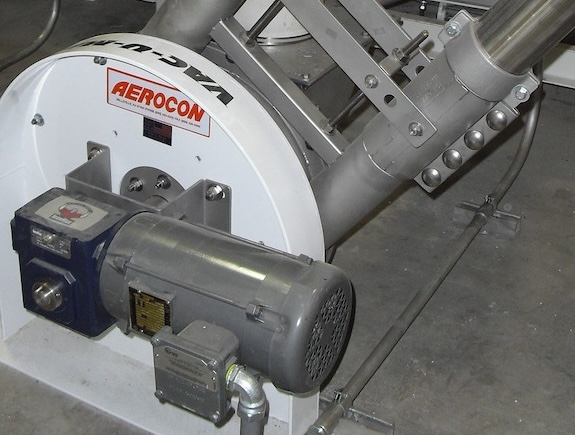

Aero mechanical conveyors are regularly used as an alternative to pneumatic conveying using two parallel tubes with a sprocket on each end, and a drive motor on one end. Inside the tube is a cable with discs on it, often called a cable assembly. As the cable assembly moves, it displaces air and material, thus fluidizing the material, carrying it in suspension along the conveyer to the outlet using centrifugal force.
Aero mechanical conveyors move material at approximately 20 ft3 per minute with a 3 HP motor, contingent on material bulk density. Depending on the design of the conveyor, the cost of a mechanical conveyor vs. a pneumatic conveyor for the same output can be one third the cost.

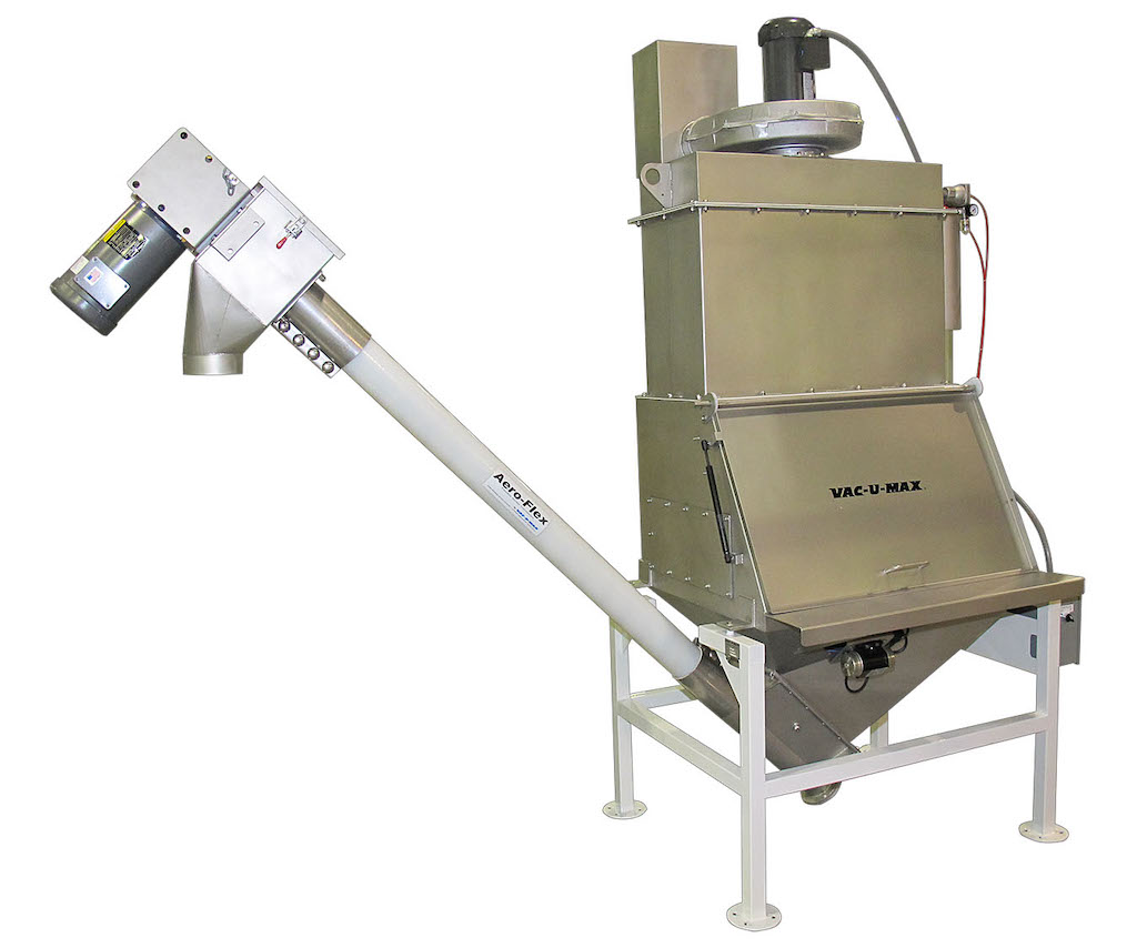

Flexible screw conveyors provide many of the same benefits, such as speed, as aero mechanical conveyors. Flexible screw conveyors, however, utilize only one tube and instead of a cable assembly, they contain a metal spiral that rotates. The spirals look like a stretched slinky or spring (that doesn’t compress), having the same diameter from end to end.
Flexible screw conveyors move less material than aero mechanical conveyors, but they operate continuously, unlike aero mechanical conveyors. A common use for aero mechanical systems is batch processing; and, a flexible screw is ideal for continuous, batch or intermittent processing. Both can convey 2000 lbs of material into a mixer in 10 minutes, but the flexible screw conveyor can continuously operate. Aero-mechanical conveyors require a metered infeed, and they must start-up and finish without material in the tubes. Flexible screws also can be started and stopped with a headload of material at the feed end.
Conveying with flexible screws is common, which leads some to look at the equipment as a commodity item, which is not true. Heavy-duty flexible screws are more rugged than the standard and last longer, meaning less maintenance and downtime, and therefore lower replacement expenditures. Rugged flexible screws often come with two-year guarantees against twisting out, unraveling or breaking.

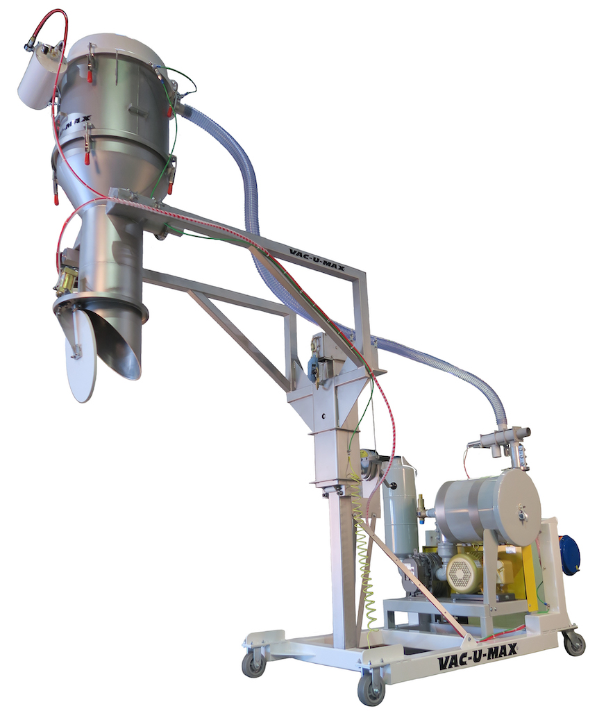

Mobile and column lift conveyors are complete conveying systems that raise and lower vacuum receivers in order to load mixers, reactors and other processing equipment and then bring the vacuum receivers back down to ground level for cleaning or sanitizing.
Mobile and column vacuum conveying systems, when constructed within Food Safety Modernization Act (FSMA) sanitation regulations, are ideal for food, nutraceutical and pharmaceutical applications.

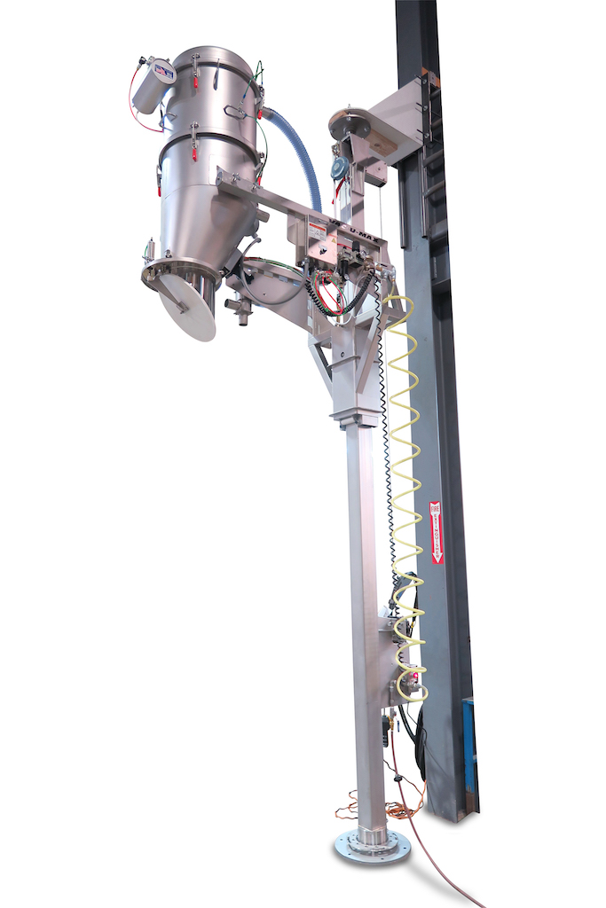

Column conveyors utilize an electric lift mechanism with a remote pendant, controlled by an operator standing a safe distance away, to raise and lower vacuum receivers above mixers, blenders, reactors, and other process vessels with fill ports 15 ft or more above the floor.
These systems, with top and bottom anchors can load side-by-side process vessels from paper bags, drums, IBC’s, boxes, bulk bags, silos, storage containers and feed bins.
Mobile conveying systems operate in the same fashion as column lift conveyors, but are portable, movable with one operator, and able to service multiple process vessels at varying discharge heights. When not in use, operators can roll these vacuum conveying systems from the work area to save on floor space.
The ability for operators to bring equipment down to floor level for cleaning reduces downtime, labor costs and potential injury costs.
