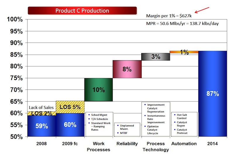

The effort to conduct rapid OPE gap analyses enabled PMT to identify the offending OPE issues for one year of operations and assign the business impact value. The business impact was identified for each classification of event, taking into account lost production opportunity, maintenance costs, and yield loss.
Once the gap analyses were completed at each of the strategic sites, plant teams began designing the potential solutions, likelihood of success, costs and benefits, and time lines to execute. Under the oversight of the plant manager and integrated supply chain vice president, near term projects were tracked on the annual operating plan along with the OPE growth goals. PMT has extended OPE to become a key aspect of the five-year strategic planning process, which is updated annually with forecasts of growth in OPE. Business leadership now has greater visibility into plant utilization gaps that enable decision-making for future expenditures; whether they are reliability, work process improvement, process technology, automation, or capacity expansion.
Between 2006 and 2009, Honeywell PMT realized OPE growth from 70% to 75% across the system contributing to $126M in operating income growth. The OPE effort was largely responsible for PMT’s growth in overall margin from 10% to 14%. As of 2011, OPE had grown to 78% across the system against a gross revenue of approximately $5.6 billion with a margin of just over 18%. Stretching the OPE growth at its sites has been an integral piece of PMT’s business improvement.
