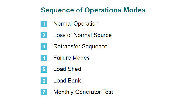

4. Are there often overlooked details you’d like to point out about sequence of operations?
Unfortunately, failure modes are not always thoroughly considered. Most systems have a single sequence that does not consider other variations. Additionally, if the system is expected to be response to failures or modes, the detailed sequence allows the system to be more responsive and resilient.
