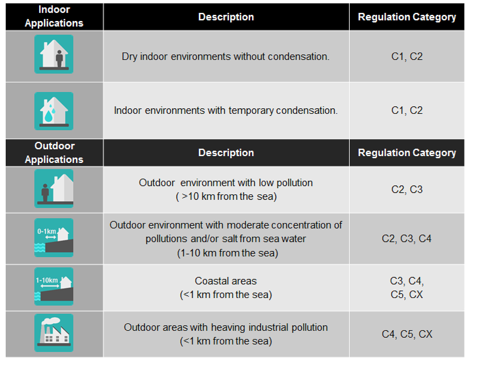

The ISO 9223 standard for corrosion of metals and alloys specifies two methods for evaluating the atmospheric corrosivity of a site. The standard specifies corrosion categories based on atmospheric wetness and pollution.
Categories C1, C2, C3, C4, C5 and CX, with CX being the harshest, are assigned to a variety of indoor and outdoor locations based on onsite tests conducted to record the deposition rate of corrosive material and by calculating the protection coefficient for the location. Table 1 lists the corrosion categories that are applicable for various indoor and outdoor applications.
The ISO 9226 standard also defines corrosivity categories C1, C2, C3, C4 and C5 for some standard metal specimens based on their corrosion rate as shown in Table 1.
Equipment manufacturers can use the corrosivity categories defined by the ISO-9223 standard as a basis for selecting optimal corrosion-resistant material or implementing protective measures for their equipment. The ISO-9223 standard does not take into consideration the design and mode of operation of a product, which can also influence its resistance to corrosion.

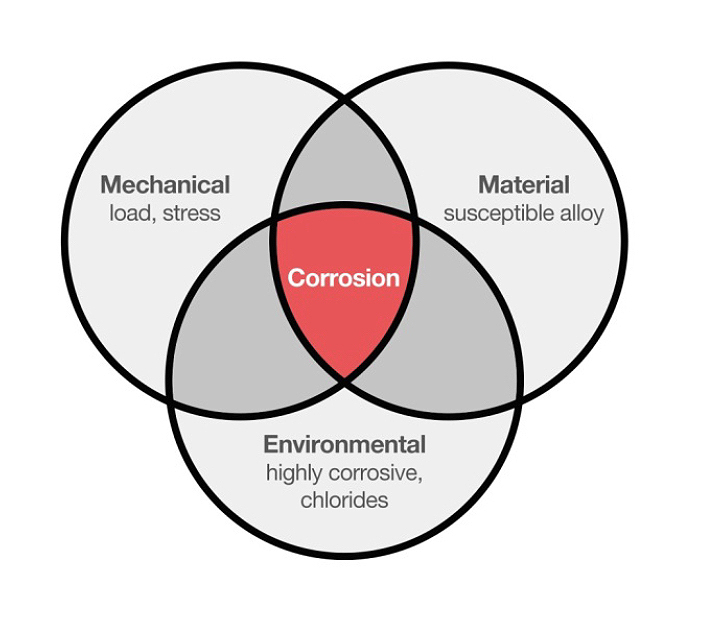

Corrosion is a chemical reaction that occurs when exposed surfaces of metals are chemically attacked by gases or liquids, resulting in oxidization of the metals. Although some metals have an inbuilt capability to resist corrosion, high temperatures and the presence of acids and salts in the environment can accelerate corrosion of metals. In addition, a metal that is highly active tend to corrode easily. Corrosion compromises the stability of metals, triggering entropic change in the metal.
In addition to the composition of materials used, mechanical and environmental factors can trigger corrosion in industrial equipment. Courtesy of: Moxa
In addition to the composition of materials used, mechanical and environmental factors can trigger corrosion in industrial equipment. A continuous load or stress on a machine part or a join can accelerate the degradation of the part, causing corrosion. Gases and liquids present in the operating environment can trigger corrosion or accelerate the wearing off of metal surfaces.
In a typical industrial environment, there are many corrosive elements like water, oxygen and carbon dioxide. In addition, chlorine and sulfides are also highly corrosive. The extremely adhesive nature of these elements make them key triggers of corrosion in metals. Another factor that triggers corrosion in industrial environments is high operating temperatures. Industrial products typically have a fan-less design that helps maintain system stability. However, an operating environment with continuous high temperatures can accelerate corrosion of metals.

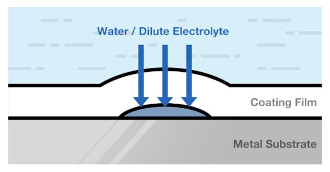

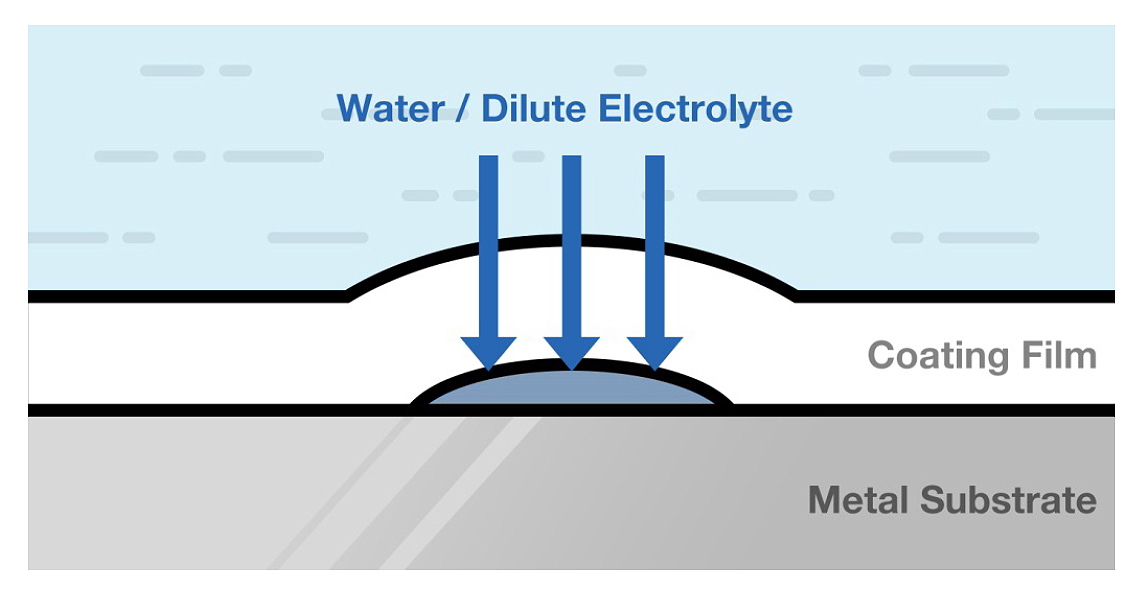

Water-osmotic paint offers less resistance to corrosion than powder-based paint. Osmatic activity causes blisters in the coating layer. Osmotic blisters may develop between the paint and base substrate, between coats of paint, or within the matrix of a single layer of a composite paint film. An example of a blister caused by water osmosis in a metal substrate coated with water-soluble salt-based coating film is shown in the following diagram. When the film comes in contact with water/low concentration of electricity, water will start to seep in. When the concentration of water is the same on both sides of the coating film, the film will pop out to form a blister.
