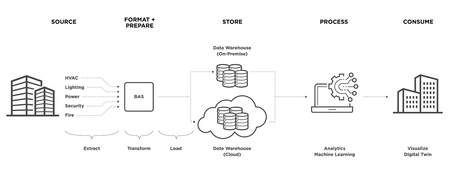

A data supply chain has the following key steps:
1. The Source: This refers to the origin point where each individual piece of data is created. Reliability is key at this stage. An unreliable source of data will impact every other step along the way.
2. Formatting and Preparation: At this critical stage, the data that was created by the source is transformed. The transformation involves applying a set of rules of functions to the extracted data to make it functional for the end user.
This step also includes data cleansing to help ensure that only the appropriate data will go through the process. One of the biggest challenges in this phase occurs when there are a variety of systems trying to interact and send data in varying formats, which may differ from what is needed by the end user.
Another key process in this step is checking for data integrity to maintain data accuracy and consistency over its life cycle.
Furthermore, the importance of formatting and preparing data appropriately cannot be overlooked. No matter the quality of the data extracted, if it isn’t transformed to meet the needs of the end user, it might as well be thrown out.
3. Storage: Once data has been formatted and prepared, it is passed along to a data lake or data warehouse depending on the specific needs. A data lake stores unstructured, semi-structured, and raw data. Data lakes generally do not require transformation of the data prior to storage. However, the stored data requires formatting and preparation (transformation) prior to processing and use.
On the other hand, a data warehouse stores structured, transformed data that is ready to be utilized. Prior to storage in a data warehouse, the data undergoes many of the transformation processes discussed in the formatting and preparation stages.
It’s important to consider data storage methodology as the selected method impacts where the data will need to be transformed within the data supply chain, overall data supply chain costs (data lake vs. data warehouse), and the ultimate end goal.
4. Process: In this step, a variety of processes can be applied to the stored data. Understanding which processes the data will undergo at the beginning of a project is vital as each process may have specific data structuring requirements to properly implement. For instance, this stage is where raw data stored in a data lake is transformed for use. Machine learning and analytics are both processes that rely heavily on the transformed data.
5. Delivery and Consumption: This phase is what most people think of when referring to data analytics, machine learning, and data visualization. We are the consumers of data and our decisions and inferences are made based on what is presented to us. However, some data supply chains are fed into other, more complex, data supply chains.
Courtesy: Henderson Engineers
