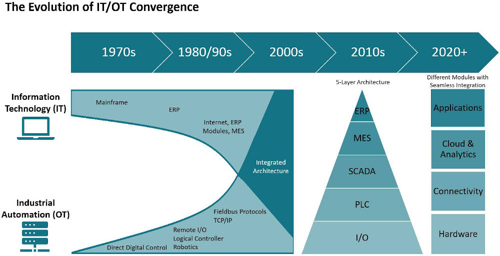

This history is critical to understand to explain why things are the way they are today, and to decipher where an organization should go next (see Figure 1). Legacy breadcrumbs often remain, which still challenge us today — industrial communication protocols that are open and insecure, island networks remain, which need to be re-networked into an enterprise-wise architecture and ownership of the industrial IT infrastructure is often not fully established. The connectivity surge can expose systems to cybersecurity risks that can seriously threaten businesses’ health, leading industrial control system (ICS) cybersecurity to boom into a multi-billion-dollar industry decades after the underlying environment first emerged.
Figure 1: The evolution of IT/OT convergence is critical to understand to explain why things are the way they are, and to decipher where an organization should go next. Courtesy: Grantek
