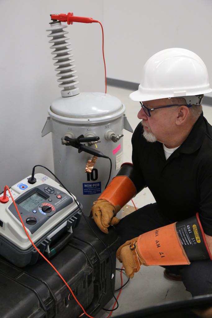

Figure 1: Performing a predictive/preventive insulation test on a transformer. Courtesy: Megger

Insulation resistance and ground testing
Monitoring for insulation resistance is paramount in CBM and is very easy to test. It monitors the condition of equipment in that it can alert the tester to water ingress, contamination and physical breakdown from things like vibration and electrical disturbances, as well as general long-term wear.
With a good quality tester, test results are easy to interpret because the range of measurement is vast — from Tera-Ohms continuously down to Megaohms. The person reading the measurement has a window that can be easily checked at any time and provide a look at where the equipment is on its life cycle. This allows for an early warning of anything happening beyond normal wear — like excess moisture ingress.

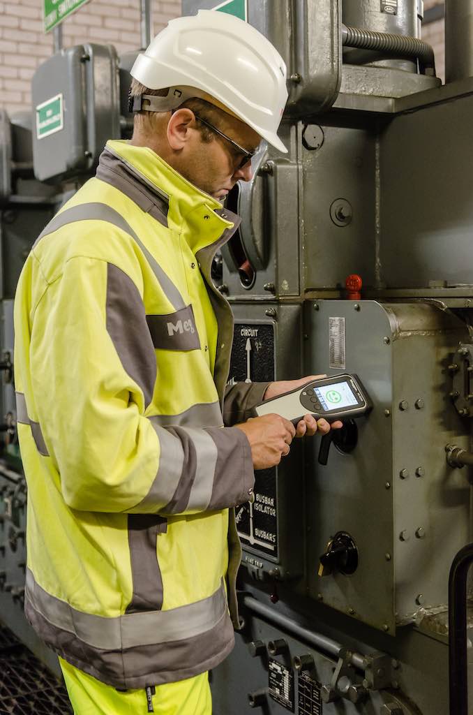

Figure 4: Checking for partial discharge on medium- and high-voltage equipment provides an early warning of future breakdown. Courtesy: Megger

Partial discharge is also a concern, especially in transformers. Deterioration of bushings and other components can cause electrical leakage to the atmosphere. Partial discharge testers are specifically designed to meet this challenge, identify and localize partial discharge. These can be used in CBM.
