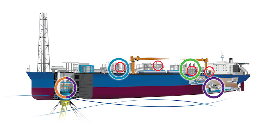

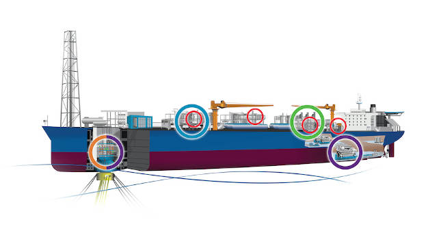

Today’s topside applications and packages are increasingly specialized. Major capital projects, FPSOs included, commonly involve numerous engineering, procurement, and construction (EPC) firms from different global regions. EPCs are responsible for equipment for several critical packages, and successful coordination with each of them is essential throughout the pre-front-end engineering and design (pre-FEED) project stage. Depending on the owner/operator’s available resources, this can be a challenge.
Figure 1: FPSOs contain numerous critical fluid system applications and packages, each of which must deliver long-term reliability across the vessel’s life. Courtesy: Swagelok

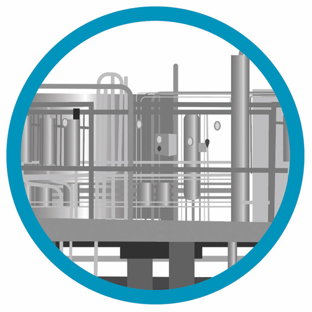

Process and analytical instrumentation. It is not always a guarantee that the right expertise will be readily available at a project’s outset to make the right product, material, and design choices for efficient and effective analytical systems. As such, overall system design can pose an early challenge. Poor installation practices during hookup and commissioning can additionally lead to longer project lead times or may result in leakage, emissions, and safety concerns. For these reasons, it can be beneficial to consult with your fluid systems providers to overcome these challenges.

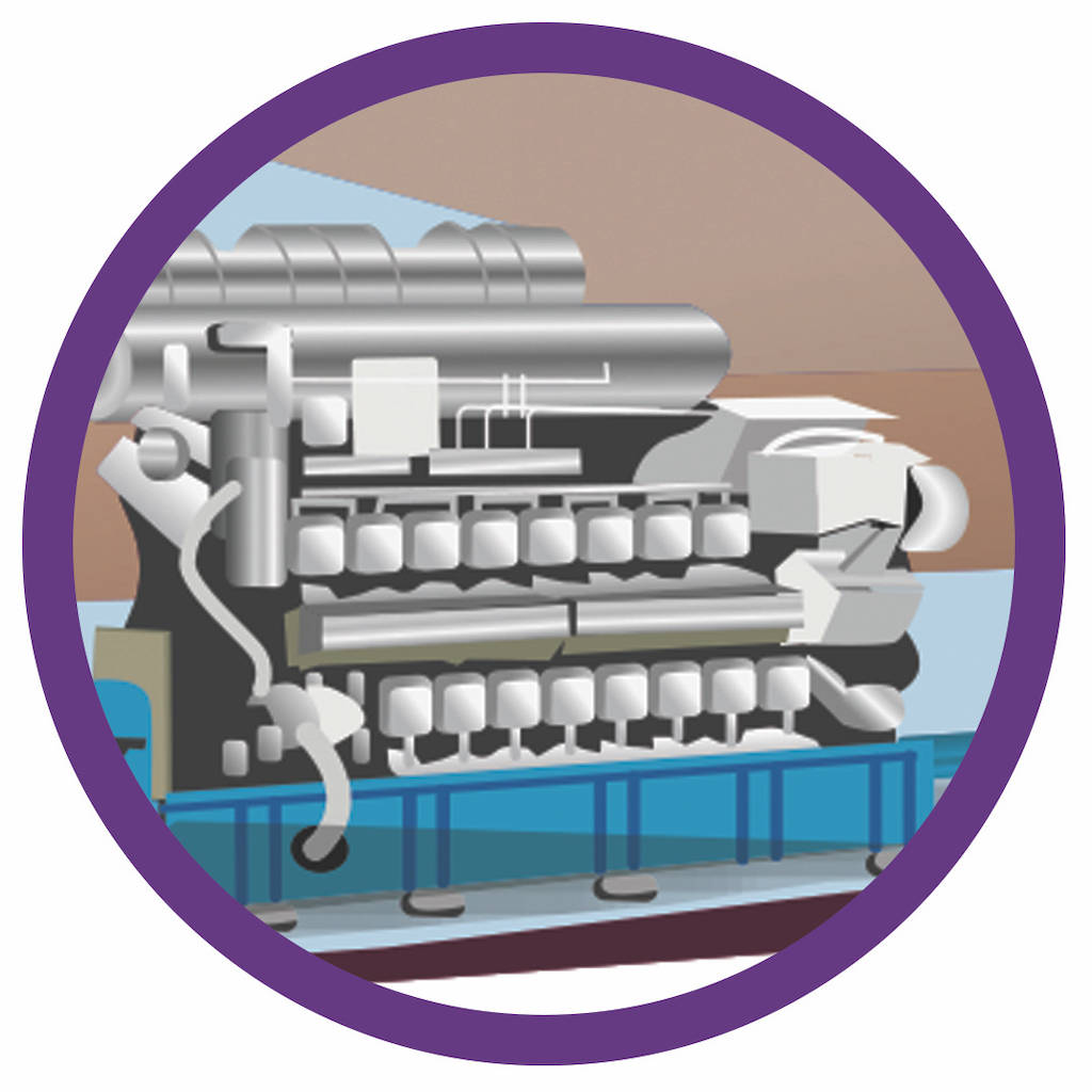

Rotating equipment (Figure 2). Pumps, compressors, and turbines are essential to an FPSO’s overall reliability. If any of these systems malfunction, the resulting downtime can lead to costly shutdowns. Dependable mechanical seal support systems—which keep seal fluid clean and deliver fluids at the right pressure and temperature—can contribute to higher reliability, helping to keep these critical units running effectively.
Figure 2: Rotating equipment, including pumps, compressors, and turbines, are critical to overall operational reliability. Downtime can lead to production shutdowns and profit losses. Courtesy: Swagelok

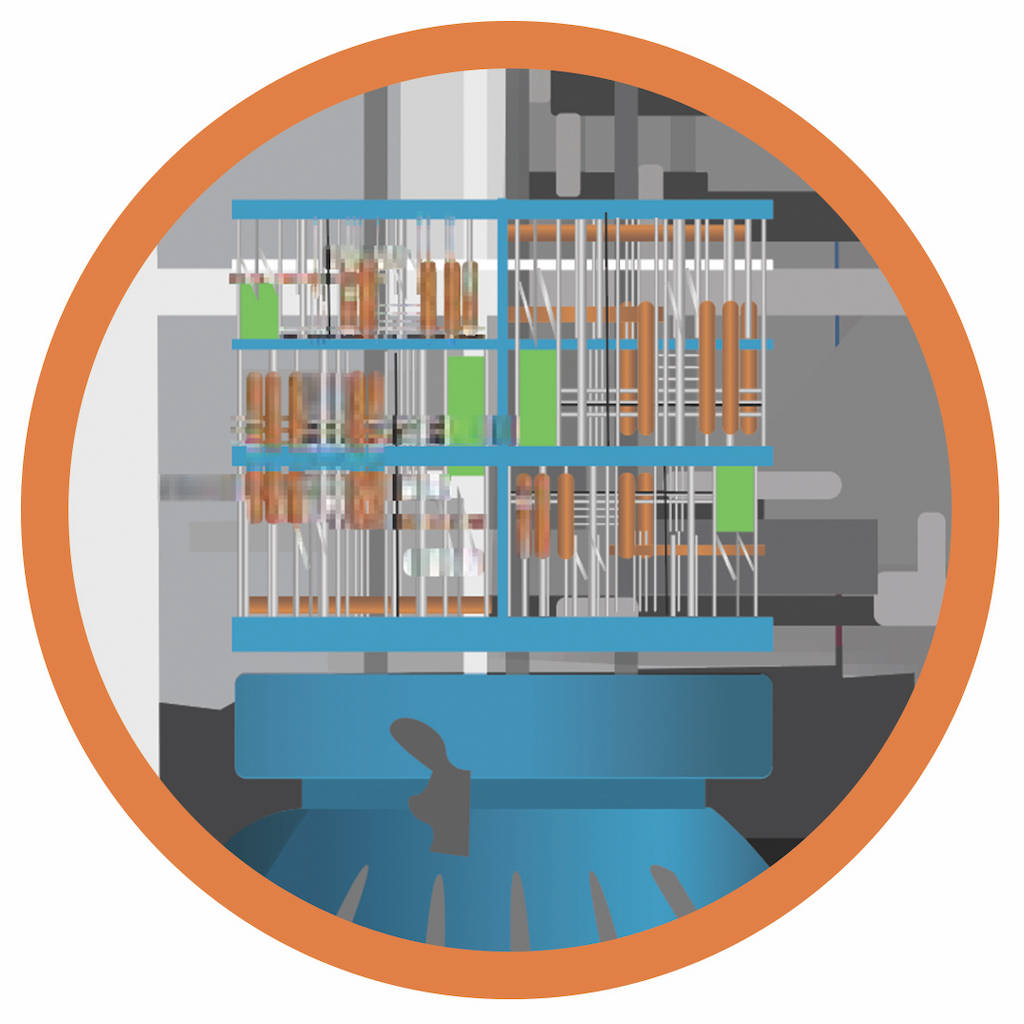

Turret swivel systems (Figure 3). These systems connect an FPSO’s topside and subsea systems, commonly using long hose lengths to make such connections. However, hoses require frequent maintenance inspections and may only provide a few years of service depending on environmental and operational conditions. Hose-related production losses can lead to millions in costs. Instead, turret swivel systems can be designed with permanently installed tube and only short jumper hoses for flexibility. These kinds of systems have been shown to decrease maintenance requirements and improve overall reliability.
Figure 3: A turret swivel system provides crucial connection points between topside and subsea systems. A well-designed installation using permanently installed tube can offer a more reliable and lower maintenance solution. Courtesy: Swagelok

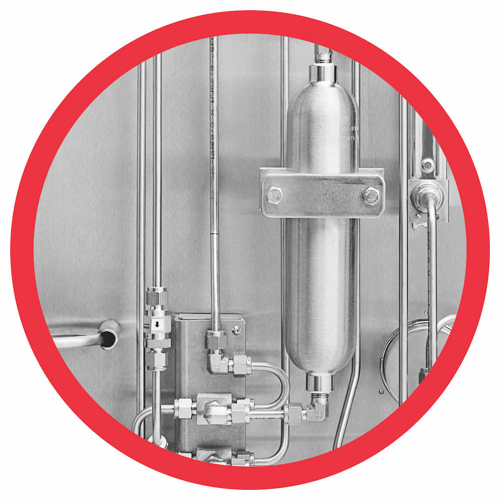

Sampling systems (Figure 4). Many different sampling processes are required on a typical FPSO. However, it is not uncommon for these sampling points to be inconsistent, system-to-system. This kind of inconsistency, both in system design and operability, can lead to compromised sampling accuracy. Instead, owners/operators can specify properly-designed and intuitive-to-use sampling systems across the entire vessel, helping operators maintain chain of custody, compliance, and proper process control.
Figure 4: Sampling systems must be properly designed to deliver representative samples and allow operators to safely use the system, maintain chain of custody compliance, and make proper process control decisions. Courtesy: Swagelok
