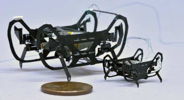

HAMR-Jr, a robot inspired by the cockroach and designed to do incredible things, is the brainchild of University of Colorado Boulder engineer Kaushik Jayaram and colleagues at Harvard University, gives a whole new meaning to the word small: HAMR-Jr can squeeze onto the surface of a penny and weighs less than a paperclip. Don’t let its size fool you, though. This four-legged robot can also carry up to 10 times its own weight in cargo and hits top speeds that, for its size, are comparable to a cheetah bounding over the Serengeti.
“HAMR-Jr can achieve gaits that approach an animal-like mechanical dexterity, demonstrating that we do not need to compromise design complexity or manufacturability to reduce the size of our robots,” said Jayaram, an assistant professor in the Paul M. Rady Department of Mechanical Engineering.
Jayaram led the design of this little-robot-that-could while he was working as a postdoctoral scholar in Harvard’s Microrobotics Lab. (HAMR stands for the Harvard Ambulatory MicroRobot). It’s half the length of its predecessor, HAMR-VI, making it one of the smallest and fastest robots in the world.

For example, traditional motors won’t work in a robot this size. They overheat when they get too small. So, the team powered HAMR-Jr using tools called “piezoelectric actuators”— thin materials that bend when hit with an electric voltage.
HAMR-Jr may also be one of the most high-tech paper airplanes out there. To make a robot that small, Jayaram explained, the researchers begin by using a laser to etch the shape of its body parts into a sheet of carbon fiber composite.
“We make everything in a plane as a two-dimensional structure and fold it up like origami to make the three-dimensional structure,” Jayaram said. “It takes a lot of time looking under a microscope to get it to work.”
