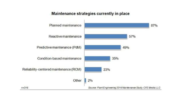

Five methods, various uses
Each of the five basic maintenance strategies — preventive (aka planned), reactive, predictive, condition-based, and reliability based —has its own distinguishing features and optimal applications.
  1. Preventive maintenance (PM)- This is a maintenance activity that takes place before something breaks so you don’t incur equipment downtime or lost product. It is almost always cheaper to do this than to wait for failure.
  2. Reactive maintenance- Just as it sounds, this is a maintenance activity that reacts to equipment failure after it occurs. However, sometimes waiting for equipment to fail is the best thing to do, as I’ll explain below.
  3. Predictive maintenance (PdM)- Maintenance based on specific information about the equipment that is a reliable predictor of imminent failure. Examples include oil analysis, vibration analysis, and thermal analysis.
  4. Condition-based maintenance (CBM)- This is often used synonymously with predictive maintenance The distinction? CBM is driven from real-time data gathered from sensors and other devices that measure specific conditions against known parameters of failure so that action can be taken in advance.
  5. Reliability-centered maintenance (RCM)- has a much broader scope, often incorporating all of the other strategies. RCM has been referred to as a process to establish the safe minimum levels of maintenance. RCM begins by answering seven questions about the equipment:
