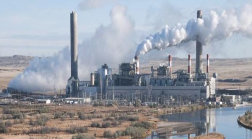

The average coal plant generates 3.5 million tons of CO2 per year. In the U.S. alone, burning coal emitted 1.87 billion tons of CO2 in 2011, according to the U.S. Energy Information Administration (EIA). Coal generates 44% of the Nation’s electricity and is the biggest air polluter in the U.S. Coal pollutes when it is mined, transported to the power plant, stored and burned (see Figure 1).
Carbon dioxide capture and storage (CCS) is a set of technologies that can reduce CO2 emissions from new and existing coal-and gas-fired power plants and other large industrial sources such as cement production and natural gas processing facilities. CCS could play an important role in reducing greenhouse gas (GHG) emissions, while enabling low-carbon electricity generation from power plants.
Figure 1: Coal is the biggest air polluter in the U.S. Coal pollutes when it is mined, transported to the power plant, stored and burned Courtesy: Technology Services Inc.
Figure 1: Coal is the biggest air polluter in the U.S. Coal pollutes when it is mined, transported to the power plant, stored and burned. Courtesy: Technology Services Inc.
